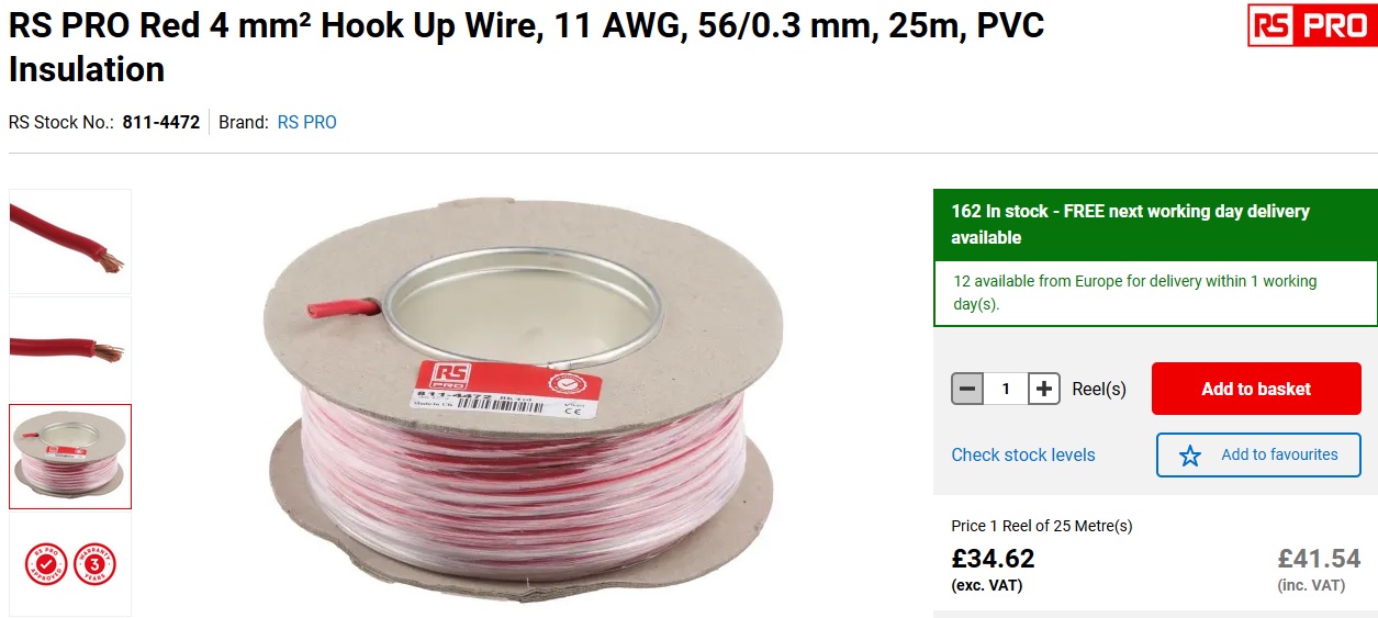

I shall need to replace the hook up wire which is RS PRO 4mm² Hook Up Wire, 11 AWG, 56/0.3 according to a long thread on the subject and the question is where to buy it other than RS themselves. If I buy from them it’s a 25m reel coming in at £60 whereas I only need 1 meter. I’ve drawn a blank with the usual searches and obviously I’ll spend the £60 if I have to but it seems a bit pricy for just 1 meter of plain old copper cable. Cheers, Alan

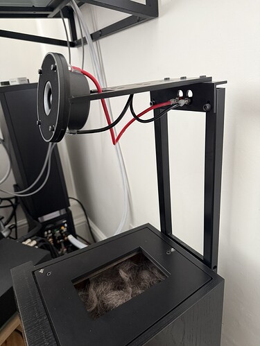

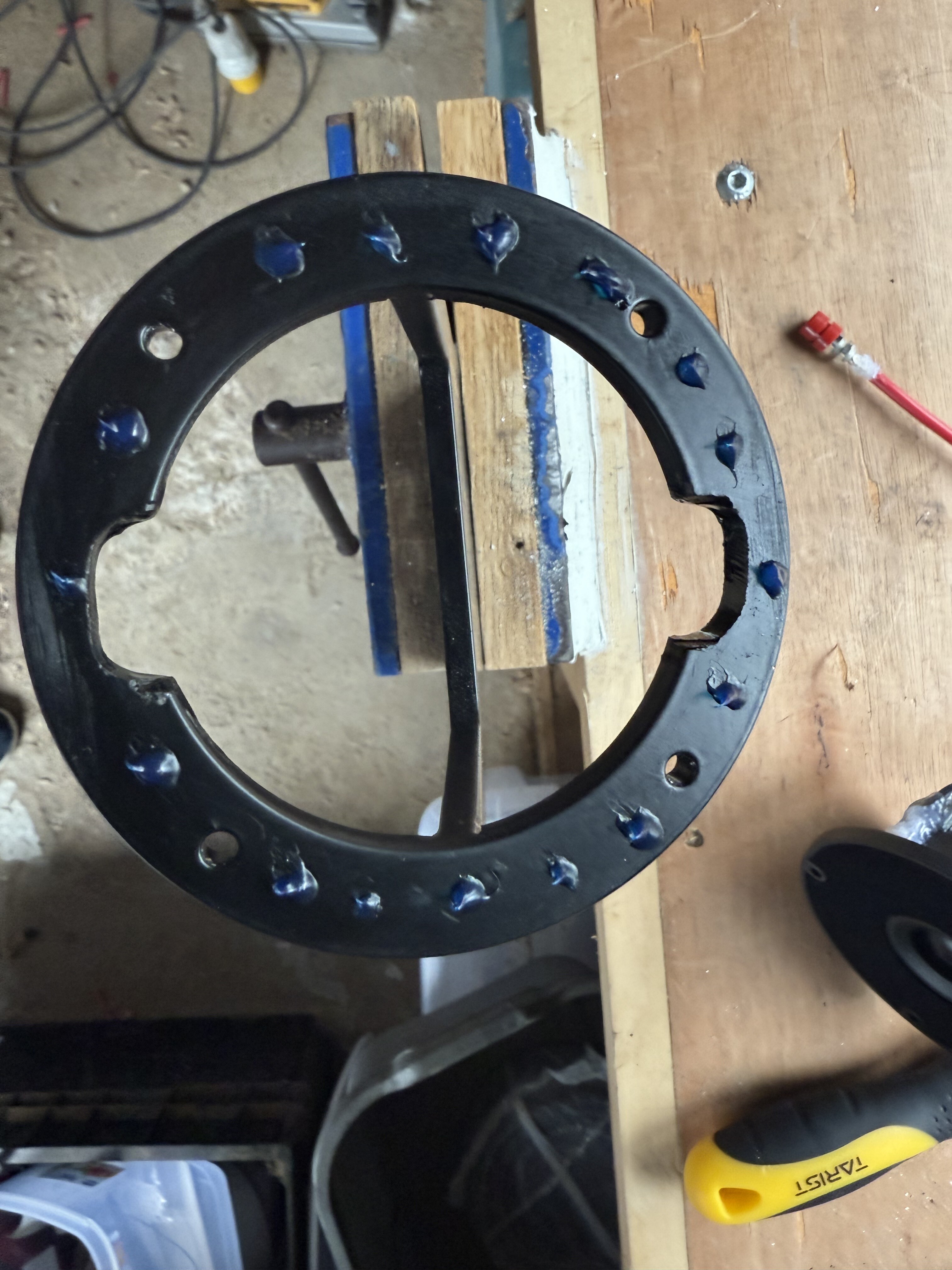

I should have perhaps explained my problem but there has been quite a lot on here about this over the last few years. The current Scanspeak SL2 tweeters have one terminal each side whereas the older model had both on the back. This means the hook up cables are too short to reach the cable sockets but also the terminals stop the tweeter fitting through the mounting ring. The only solution is to cut 5mm X 10mm rebates in the ring to allow them to pass through it and be fitted ! Not a job I really fancy but better than scrapping the speakers. I’m keeping an eye on the auction sites for the original versions but I’d only buy new or nearly new if any appear. Cheers, Alan

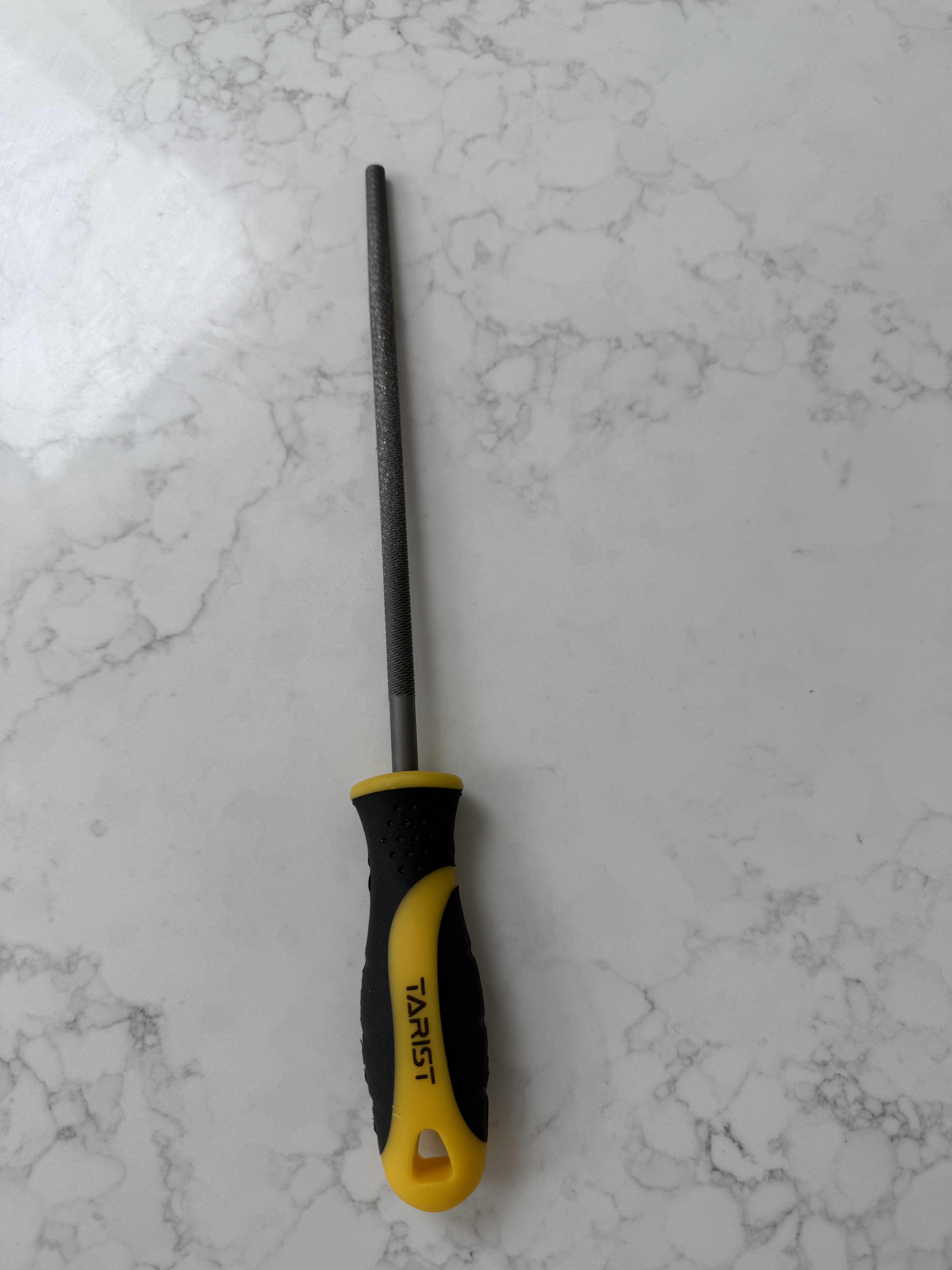

A round file would suffice, or better still a dremel with a suitable attachment. Amazon sell sets of attachments in all different profiles for metal.

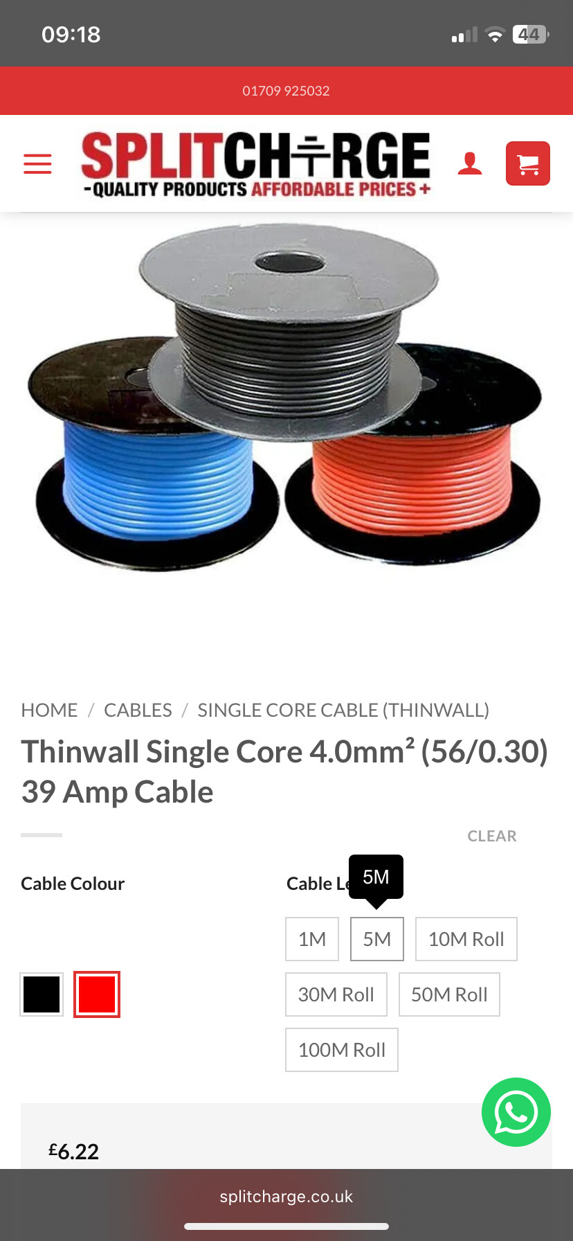

After a little googling I found these guys that sell it by the meter, or better still by 5 or 10 meter runs
I wanted the hook up wires to be hot gunned to the side of the tweeters to secure the fixing. Also. I also hot gunned all terminals so the cut outs in the tweeter fixing plate are slightly bigger than how the forum member who posted his experience a while ago did his (he did a very good job). To cut out the slots I started with a 4 1/2” grinder and finished with an 8mm round metal file. But honesty the file alone would only have taken ten mins per slot. The way I applied the Hylomar is how Jas G told me to do it. The latest tweeters sound great.
Oh and new hook up wires need to be 23cm. Original ones were 20cm. I went with 25cm to be safe but the shorter lengths would have been easier to dress.
Thanks so much everyone for all this info. and I’m spoilt for choice with the hook up cable!
Your photos are excellent Cohen and I’ll refer to them when the time comes. I take it you finished the tweeter connections before fitting through the mounting ring ? I’ve been wondering about fitting first and then solder and glue to keep the cut outs to a minimum but perhaps there’s too little space for that.
