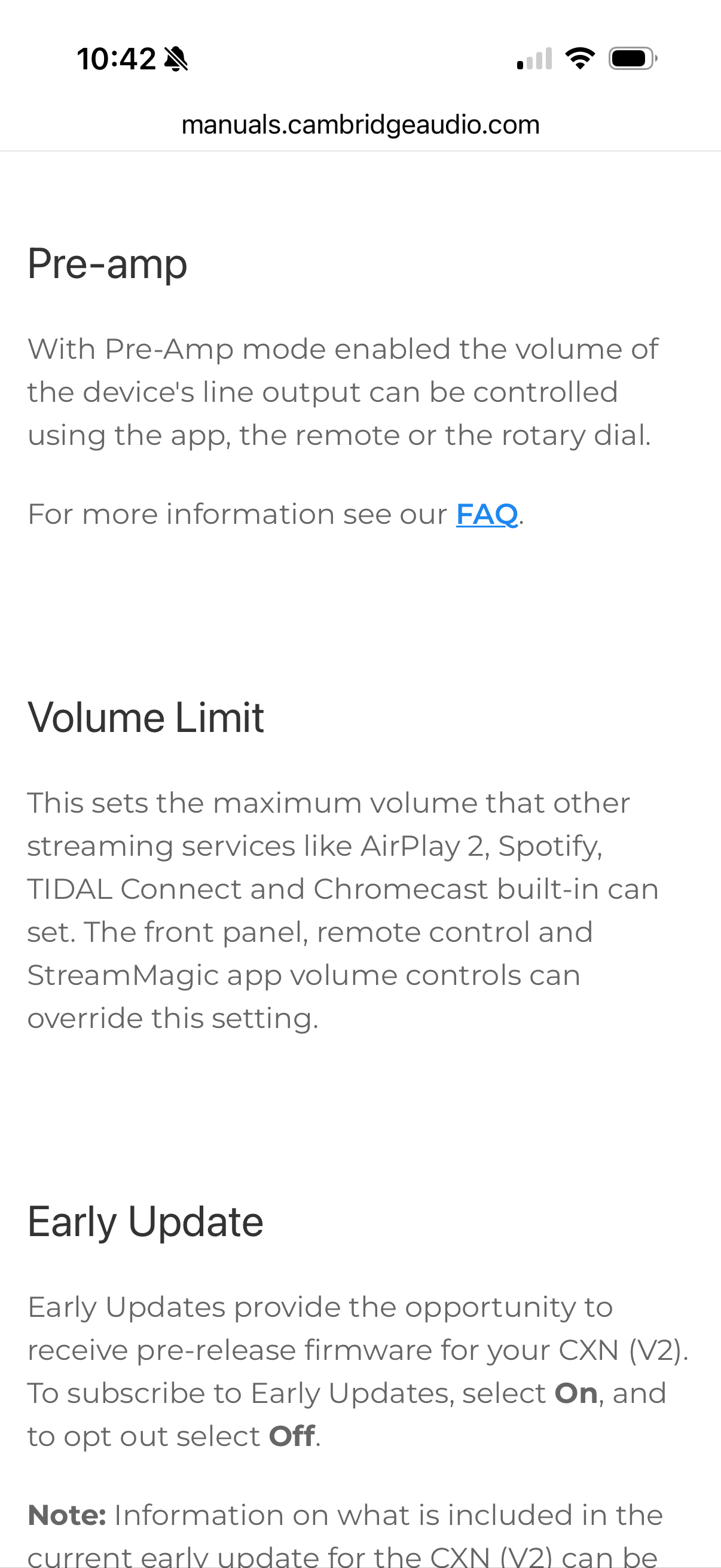

I’m using Cambridge Audio CXNv2 as a streamer into Supernait 3, all good except the fact that the SN3 remote changes the volume of the CXN, which I don’t want. Anybody seen this before?

i think your only option is to block the IR receiver with some tape on the cambridge as it would seem they use the same codes
Go to the streamers settings….IR Control…select NO IR CONTROL.
nice! didnt know you could do that!
Yes. Why is your Cambridge in pre-amp mode, in the first place? I think it’s best disalbled. (I have exactly the same set-up in the steaming department).
Some interesting ideas here, thank you good people, will try them out.
Getting the CXN out of preamp mode solved it. It’s exactly what I wanted and it’s brilliant, thanks again all.
