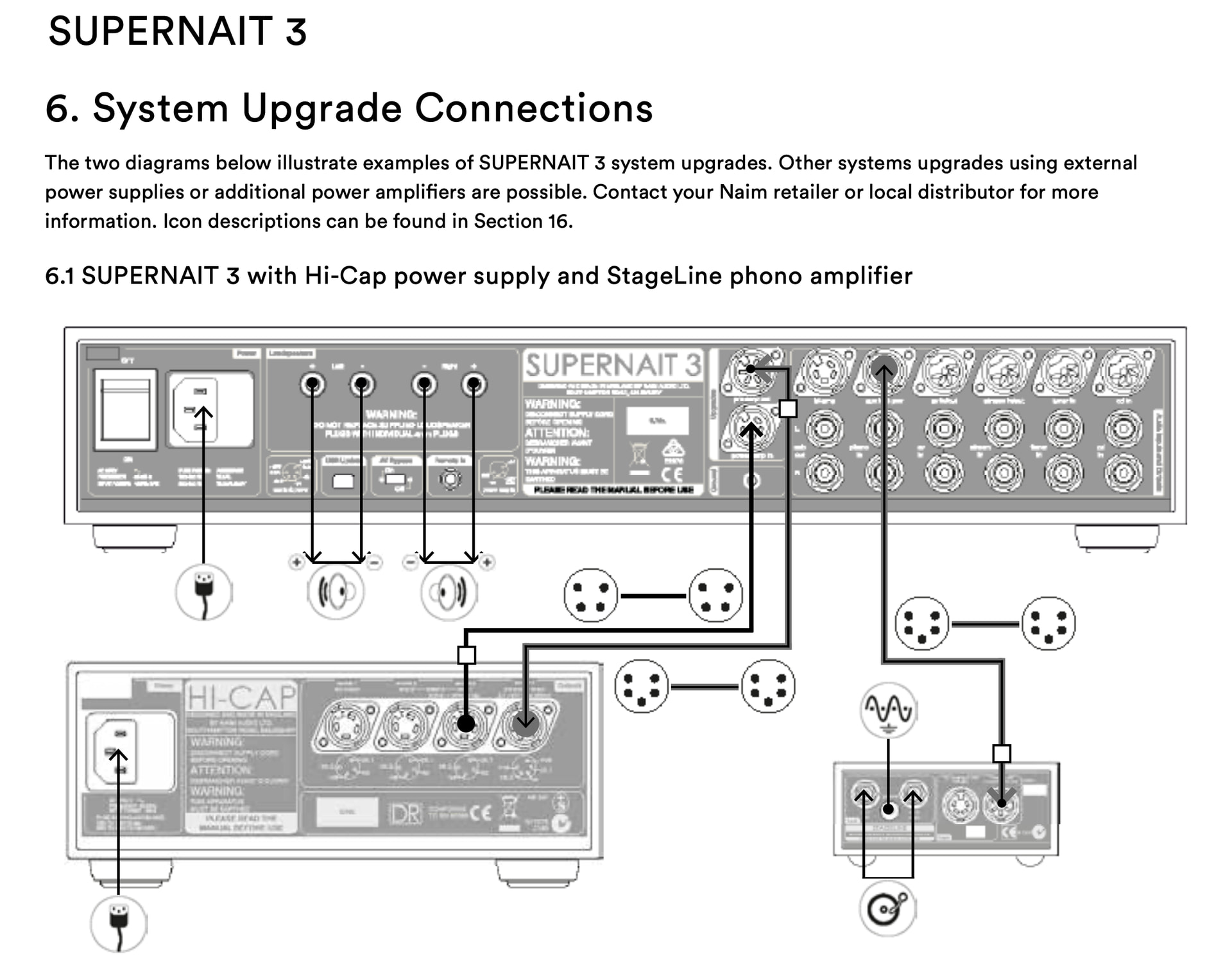

How is the HICAP connected to the Supernait 3?
Is it connected just like this with a SNAIC 4 and SNAIC5? (ignore the Stageline connection).

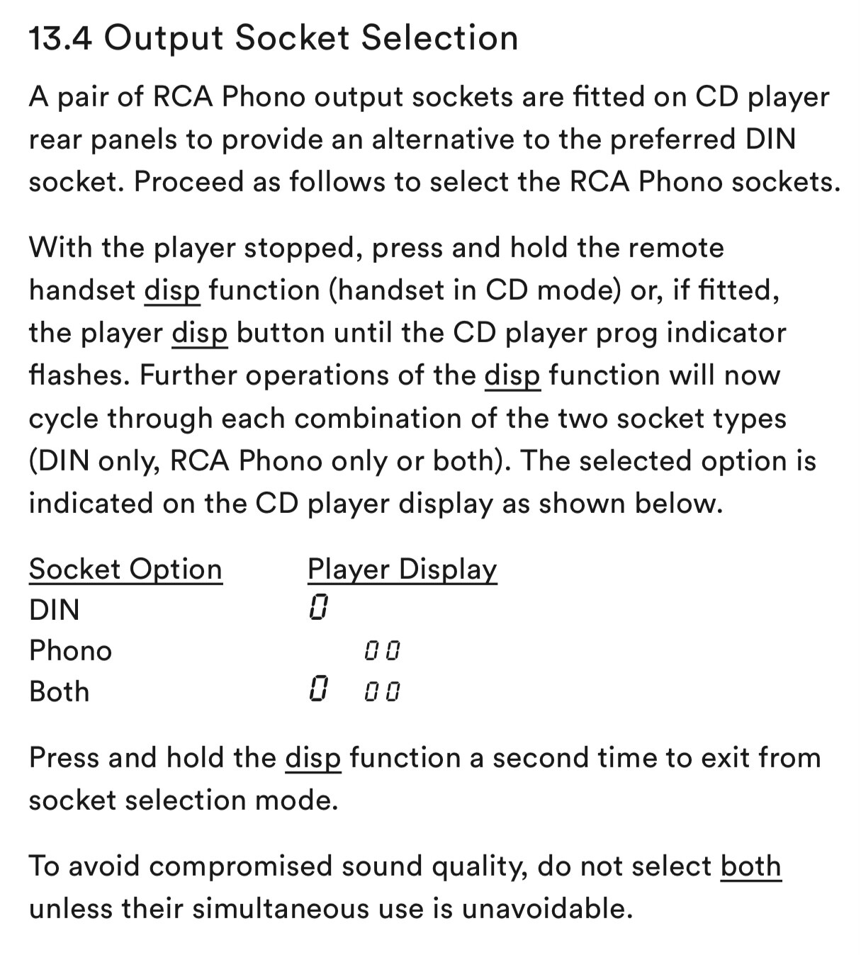

If using a CD5si into a Supernait 3 like me you will have to change the output setting to RCA if using those “ I do “
Connected exactly as per the diagram above.

Yes I did change to phono to test but reset the cd to din after no joy.
