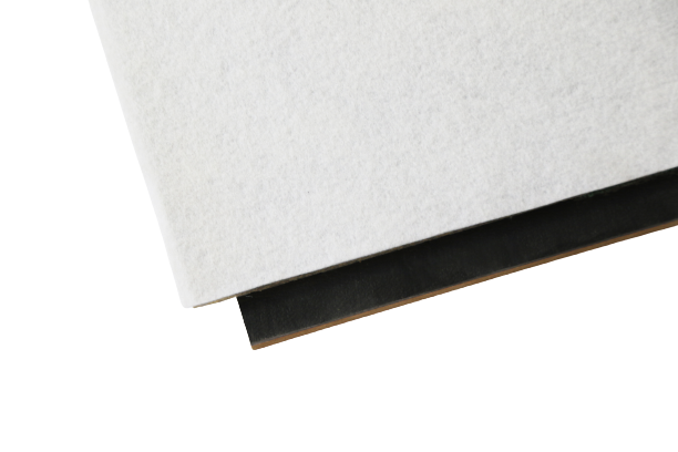

DIY stores do not seem to deal with this problem. I discovered TecSound and whilst this will probably do the job within a modest budget my body would struggle getting it into position.

The Sound Insulation store I mentioned seems to have the gear required withan adhesive backing. I will have a session with the daughter ( cottage renewal expert) and see what she feels achievable.
