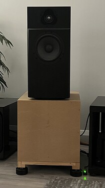

I’ve not got round to the DSP tweaks yet but the AUVA feet are on and they’ve made a big difference, things are back to being tight and punchy. These feet work better than the Gaias I’ve used for years and took for granted. Really glad I tried them.

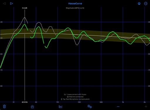

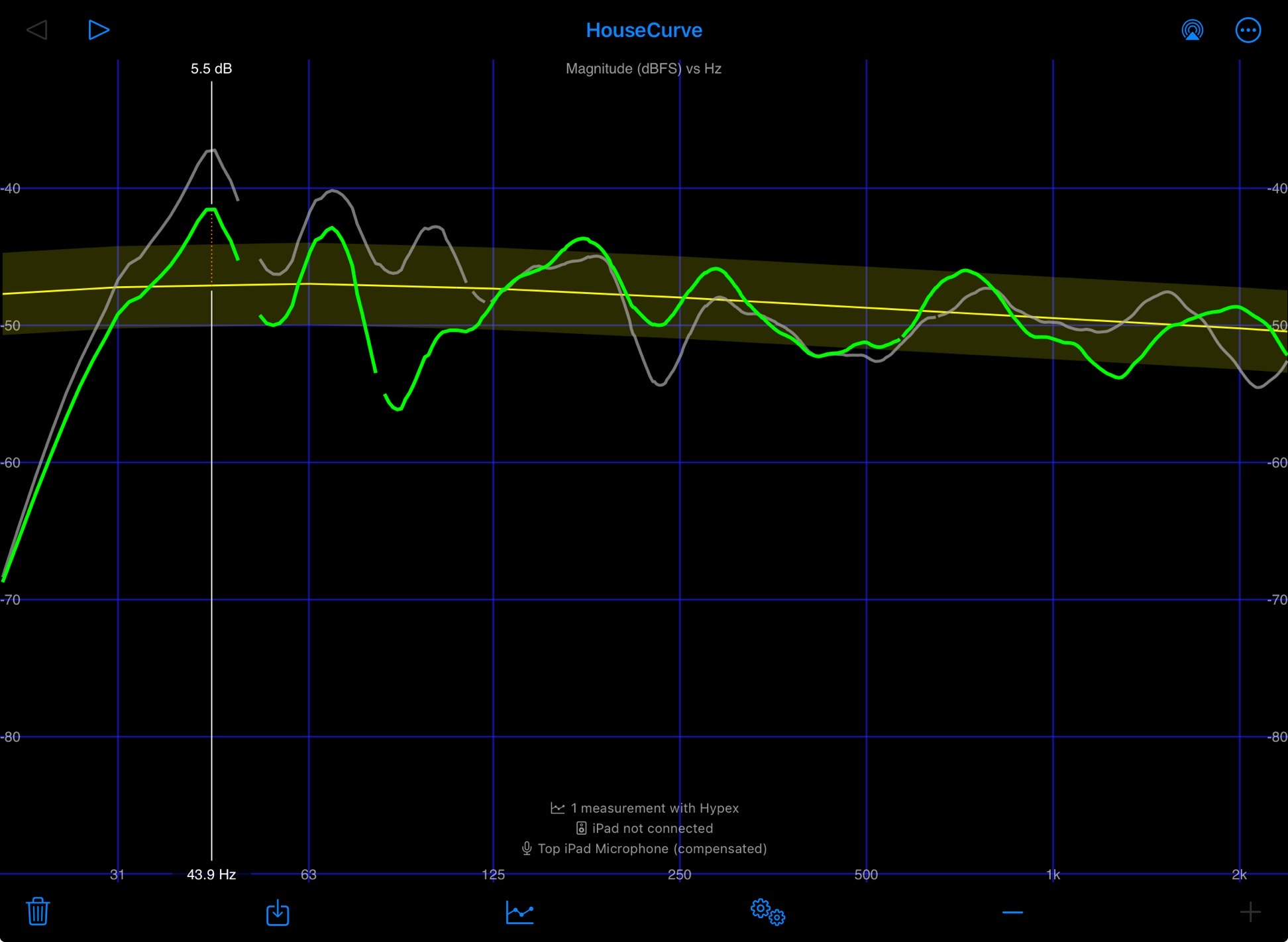

I took a couple of very quick measurements with HouseCurve that Gary mentioned above. Just on my iPad with the built in mic.
Green is the main speakers, grey is with the bass modules. The three main modes from my room are quite obvious, length, height, width respectively. Not sure what the dip at around 100hz is, maybe another mode at the height of the bass driver. Will investigate with REW and the proper mic, probably on Monday when my wife is at work!
I should be able to reduce the modes with the Hypex DSP, but not less than those from the main speakers of course.
The bass modules fall off before 400hz so the grey lines above that are likely me just holding the iPad in a different position :slightly_smiling_face:

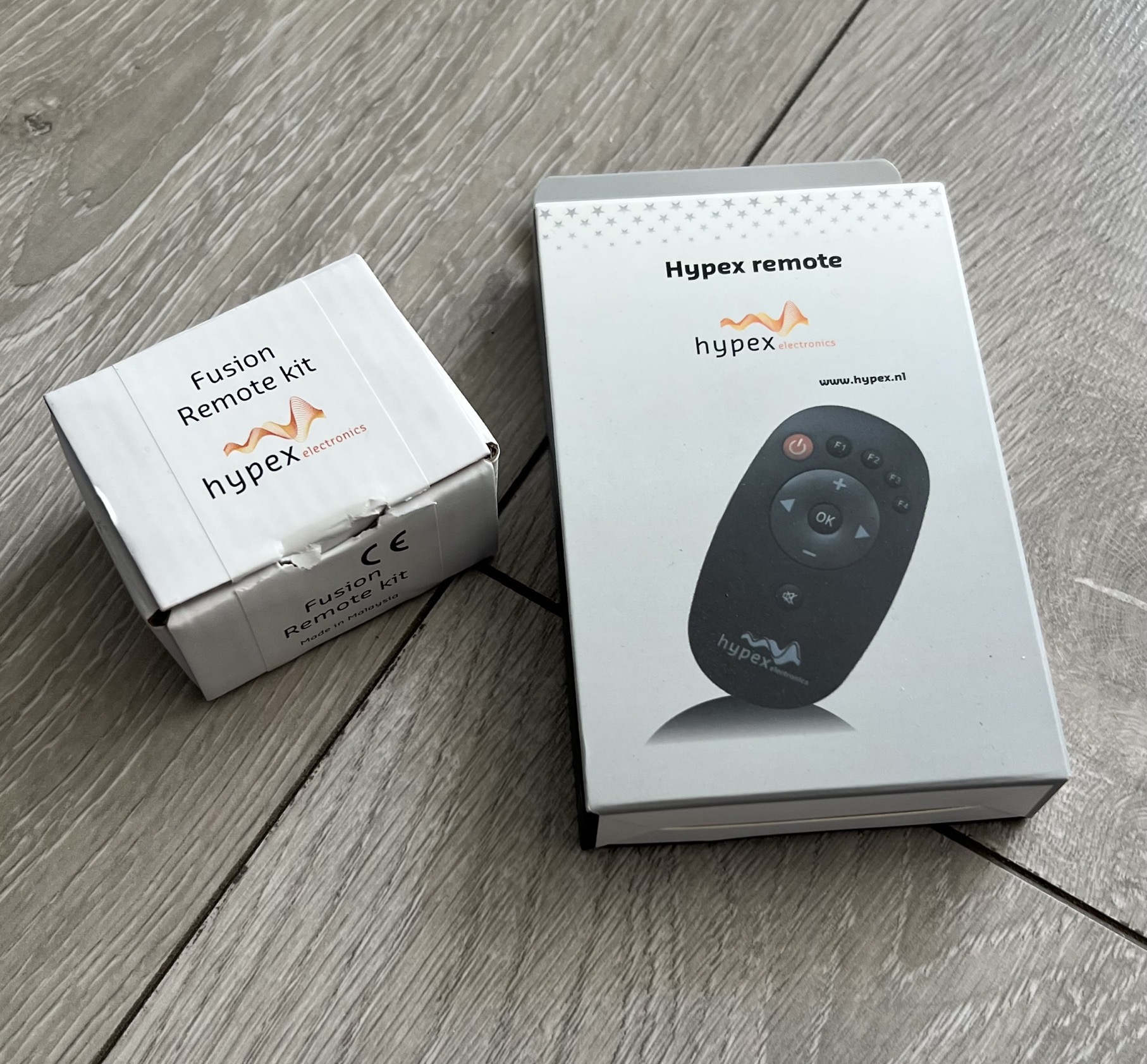

These arrived today, inexpensive and should help with the tweaking :slightly_smiling_face:
This remote was definitely worth getting. Both amps are now linked so I can now change presets on the fly, go in and out of standby etc and they both keep in sync.
I’ve not bothered mounting the receiver on the cabinet :slightly_smiling_face:
What I wasn’t expecting was the volume works as well, the Hypex manual is a bit vague about this when using the high level input, saying to use the gain knob on the amps. This is extremely useful as the mute button on the remote allows direct comparisons.
