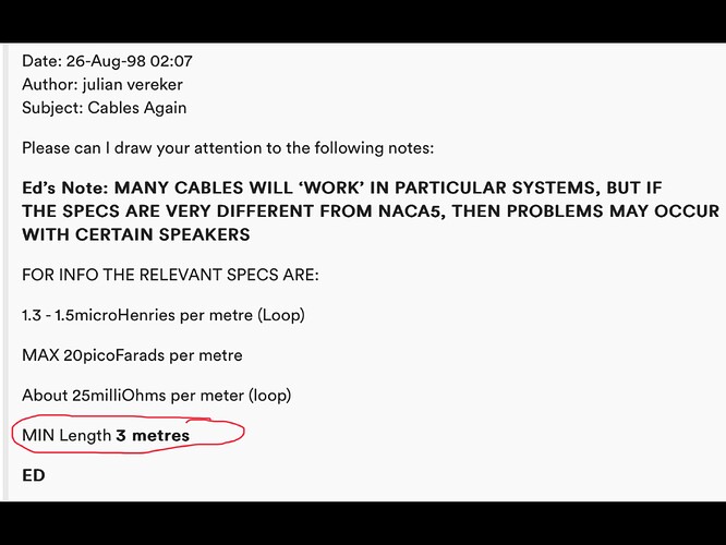

I need to move system to a smaller room. What is the recommended minimum length of cable required?
3- 3.5 metres probably. :+1:

Earlier versions of the 250 most certainly benefit from longer speaker cables. I had a 250DR for a while, and despite advice that these were less dependant on longer cables than early versions, I found mine to sound a little better with 5m compared to 3.5m of NACA5.
With virtually all non-Naim speaker cables the optimum length will be more that that recommended for NACA5. So I would suggest that you think twice before cutting your KS1 into shorter lengths.

The Naim 250 is a Naim classic design which really needs the minimum recommended inductance load of 3.5uH that 3.5m length of NACA5 with its 1uH/m brings.
Kudos have not published the inductance & other specs on the cable we can’t be sure of any of this.
I use Chord Odyssey, which is similar in many respects to KS1 in its construction & materials.
I measured that & found it was 0.6uH/m. This means it would need to be 5.8m in length to have 3.5uH inductance.
Your 5m of KS1 is not far off for a 250 and I definitely would not shorten what you have.
