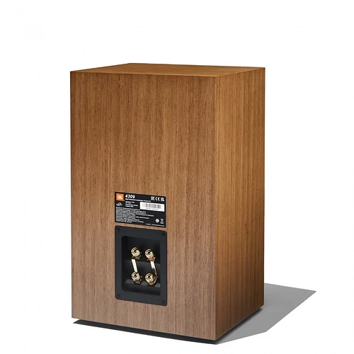

You mean just leave it as it is then:
And literally just plug in the + and - diagonally? ie. not bother with wire links? I thought wire links were supposed to sound much better than supplied metal links. But perhaps I’m wrong here?

Just use the links all the gubbins from spade to pins and the extra connections and multiple metals is a PITA
I’ve tried it many ways F type etc and the best I got was using the bars and diagonal wiring pos to top and neg to bottom
That was I tip I got from Phill Budd the speaker designer at Linn.
It cost nothing and works.

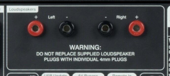

Remember when making the Naim plugs it’s a Siamese pair the polarity pin positions are each way round.
The speakers were manufactured and voiced for consistency using the link bars.
You may well find that if you open the back you can move the internal wires so that they both attach to one terminal. You can do this with ATCs and don’t even need to solder, as the wires attach with screw tags. It would be worth unscrewing the back and taking a look. It’s free too.

Thanks yes I suppose I could do that and it’s something that hadn’t occurred to me. If I was still in my ‘tweaky’ phase then I probably would. Trouble is that unscrewing the terminal plate would certainly void the warranty and also frankly you have more b*lls than me because I just wouldn’t risk it. I would be worried of causing some kind of damage. Suppose there’s an air seal gasket around the terminal block that needs replacing if it’s unscrewed? That’s the sort of thing I worry about and why I wouldn’t do it!
Just try unscrewing them. Give the plastic bit a little pull. If it drops out there is no seal and you can look at how the wires are connected. If it’s stuck fast, leave it alone. Biwire terminals are the spawn of Satan.

If you want to reduce the number of interfaces ditch the links and use F-connections. The top connections could be bananas or spades, but Naim plugs are ideal for the lower pair.
Naim plugs can work well with their amps, or they can be a PITA, especially with stiff NACA5, as they send the cables straight down and you often need to put a tight bend in them to avoid the shelf below. In this case ordinary Deltrons can work better. On the other hand they work very well on many speakers, where you actually want the cables to go straight down towards the floor. Spades or right angled Bananas like Naim’s, will do this. Straight bananas will send the cables out and down, putting more strain on the connection.

Yes with a stiff cable like NACA5 possible strain on connections and sockets does concern me. Particularly it’s always worried me on the amp. As you say it requires the cable to be bent quite sharply to clear the support surface.

I don’t think bending NACA5 is a problem. You can put a fairly tight 90° bend on it easily enough. I just don’t see the point in putting a 90° plug on it if that means you have to add another 90° bend, when an ordinary Deltron would send the cables straight out in the right direction.
With speakers it’s the opposite. Naim right angled plugs send the cables straight down where you want them.
From the Nait 50 user’s manual:
5.3 Loudspeaker Cable and Connectors:
For optimum performance, use Naim NAC A5 speaker cable.
Using cables from other manufacturers may hinder performance or even damage the integrated amplifier.
