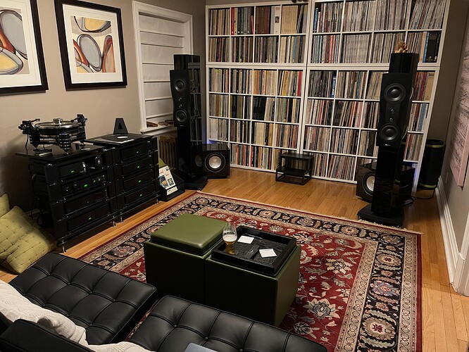

In my room, my C2s are 7’4" apart tweeter to tweeter, and I sit 9’ away from the front plane of the speaker baffles. The tweeters are 24" away from the side walls, and the front baffles are 4’ off the back wall.
I would like them in a bigger room, mostly because I think they would open up a lot more for large scale orchestra music, but I don’t feel like they overwhelm the room at all. The 300DR has amazing grip and control and the addition of a stereo pair of subs helps a lot with soundstage.
I would like to try them in my 14’ x 22’ living room, but there might be a downside. One side is all outside wall (plaster on brick) while the other side has two large arched entryways into the dining room and front hall that cannot be closed off. OTOH, my smaller listening room has just the door and I can close that if I want to.

I don’t treat my room. It has carpets, and furniture, and a wall of record shelves behind the speakers. I have heard – perhaps overly – treated rooms. They might have been “accurate” but sounded overly dead and lifeless to me. I like a bit more lively presentation. I have left my room as is and am happy with how it sounds.
Same here. I prefer the “sound” of the untreated room provided one gets it right. I have a thick rug on the floor, fabric curtains behind, fabric sofa and equipment rack on the side walls. The presentation of an untreated room might be not very orderly or accurate but I prefer this “live” presentation. Room furnishing can still make a positive difference if appropriately implemented in the room. In my previous dedicated room that is fully treated, the system sounds rather dead. Perhaps I used too much absorption although I did incorporate some diffusion at certain areas in the room.
This is how my room is. It sounds naturally lively, but has great soundstage and is very revealing. I don’t feel like I have issues with reflections in the room.
Nice. I noticed the left speaker is closer to the side wall than the right speaker as the equipment rack is further down the room. In my system, I can’t push the left speaker closer to the side wall as the equipment rack is just beside the speaker. I’ll try to find a way to see if I can reposition the rack so that the speakers can be placed wider apart. It’s a little tricky for me since I don’t have much space to play with as the side wall is already full with furniture.
No, that’s just an illusion of the photo. Both speakers are exactly 24" from wall to middle of tweeter. The optimal seating position is exactly middle of room, and that’s where the left chair is positioned. Dynaudio recommends siting speakers at least 1/2m off the side and back walls. If I had the room, I would leave a full meter between speaker and side walls.

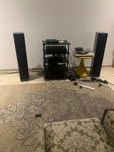

This is my room and I sit very close to the speakers as there is a bed behind the chairs
Hence my doubts about getting the C2 in this room
It’s a bit messy with cables because I just got the new WiiM pro streamer need to organise all this
I can’t really get a sense of scale for your room, since your shots are too narrow angle, but I can say C2 will want to be further off the wall than you have those Focus. All Dyns like space around them, but especially ones like C2s, or the bass won’t be right. And then it looks like you’d be sitting really close to them.
Offhand, I think you need more space if you want Confidence speakers, even with C1s. I think how I have mine is probably about a minimum for the C2s.

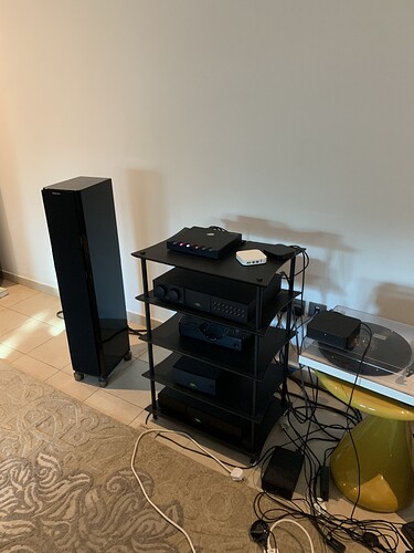

Hi this is another photo
It’s not really feasible to have the c2 0.5 meter away from the wall
And listening space to speaker is less than 2 meters
Doesn’t sound like a good candidate for C2s. They really need more space. When that close to a wall, they may end up boomy sounding, even with foam plugs in the ports. The back side of my C2s are 0.9m from the front of my record shelves standing behind them. That’s about a minimum. They were a bit closer at one time and didn’t sound as good, and the soundstage wasn’t great.
Listening distance to speaker at 2m is possibly reasonable, but siting them so close to the wall is not optimal, and makes them sound boomy. Dynaudio speakers are designed for open space, not up against walls. There are other speaker brands designed to work well against or close to walls. Maybe that should be your focus.
Personally, I wouldn’t purchase C2s for that room unless I can hear them there first. I suppose you can always buy them and resell if they don’t work out, but keep in mind the transport weight (assuming you have the wooden crates they come in) is about 175 lbs, each!.

Based on my experience with medium-sized bookshelves that are designed for open space (Harbeth SHL5+, Graham LS5/9 and Marten Duke 2), they require a minimum of 0.7m clear space from the front wall (rear of speaker cabinet to wall) and it is fortunate I could give them the space. Anything less they don’t sound good - lumpy and uneven bass response, reduced soundstage etc. The further away from the wall the better. Hence I am not surprised that the larger and more imposing Dynaudio Confidence C2 requires at least 0.9m from the front wall in your room. The only way to reduce the negatives of close placement to wall boundaries is to listen at low volume levels but it’s a massive waste to do so with a high calibre speaker.
From the photo the OP provides above, it appears that the Dynaudio Focus 260 has about 0.3m from the front wall which is rather scant. If the Confidence C2 goes in there, similarly I don’t think it will work and the sound quality will likely be worse.
