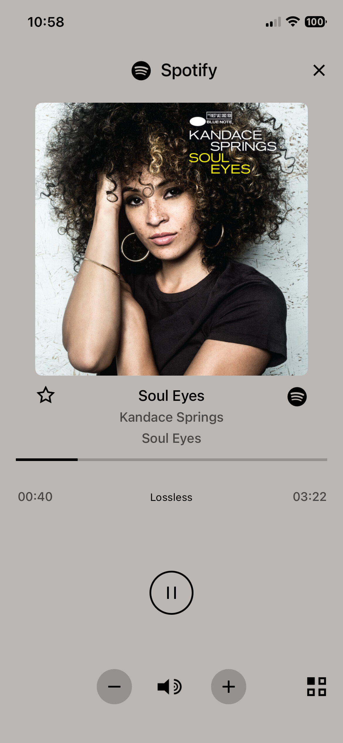

Hello, I am using a Lumin P1, but I do use Spotify lossless. For me, I can choose Spotify on the Lumin App, or cast it from my phone, or IPad using connect. In all cases it shows lossless, or CD quality in the now playing window. I am no expert, but you could try deleting the App, then bringing it in again from the App store. Have you changed the settings to Lossless in the Naim App?

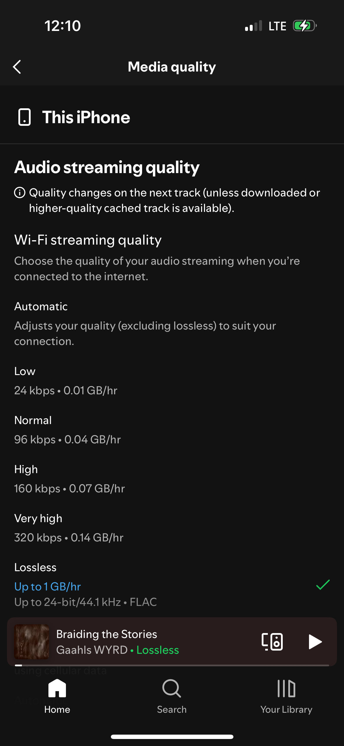

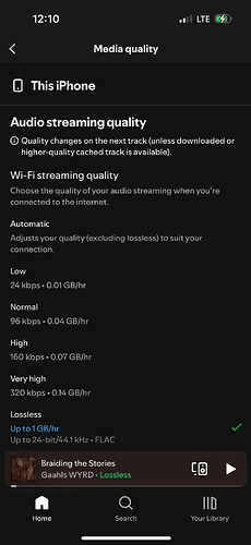

Here is my settings page in Spotify
Many thanks!
In the spotify app I also have your levels - very high for 320 and then lossless. Yes my spotify settings page is same as yours and set on lossless

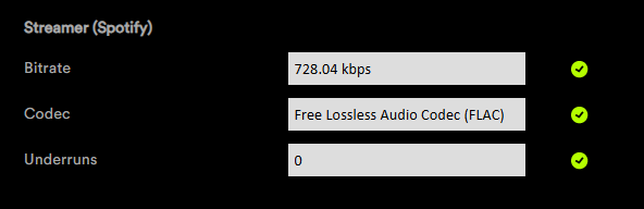

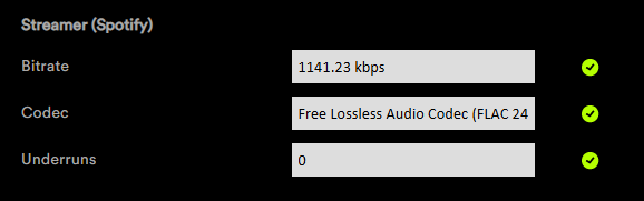

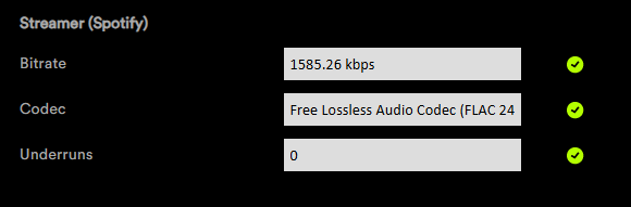

Anyway, here’s what I’ve got:
Thats very helpful. I am learning a lot here, but makes sense that the file size is smaller with less info per second eg silence. Then not just about the nominal format.
Tx Lars

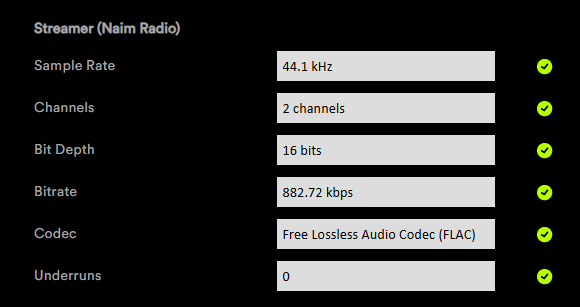

You will sometimes see an actual bitrate figure displayed, as the data rate is varying constantly depending on the recording.
If you look at the diagnostics page found by putting the streamer IP address into a browser you should be able to see exactly what’s happening. Put a 16/44.1 iRadio station on, for example, and you’ll see the data rate fluctuate.
Radio paradise main mix
