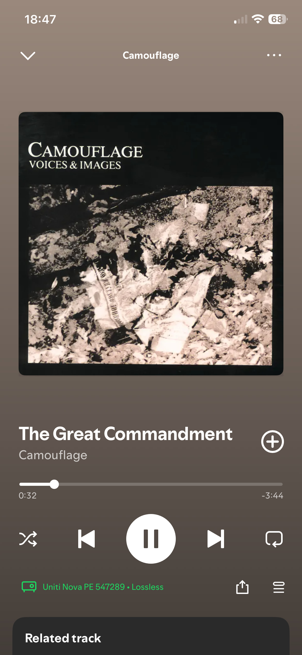

My internet speed is 150 Mbps and streaming via Tidal and from the NAS works normally. When Spotify’s audio quality is set to ‘automatic’ and I start a track on the iPhone in lossless quality and then connect it to the Uniti Nova, it plays the track in ‘very high’ quality. When I set Spotify’s audio quality to ‘lossless’ and start a track on the iPhone in lossless quality and then connect it to the Uniti, the track does appear on the Uniti Nova with the album cover, but there’s no sound. The track doesn’t play and stays stuck at 0.00 seconds. I’ve already restarted the Naim, restarted both the Naim app and the Spotify app, logged out of Spotify in the Naim app, and reset all internet connections. But the issue remains.
