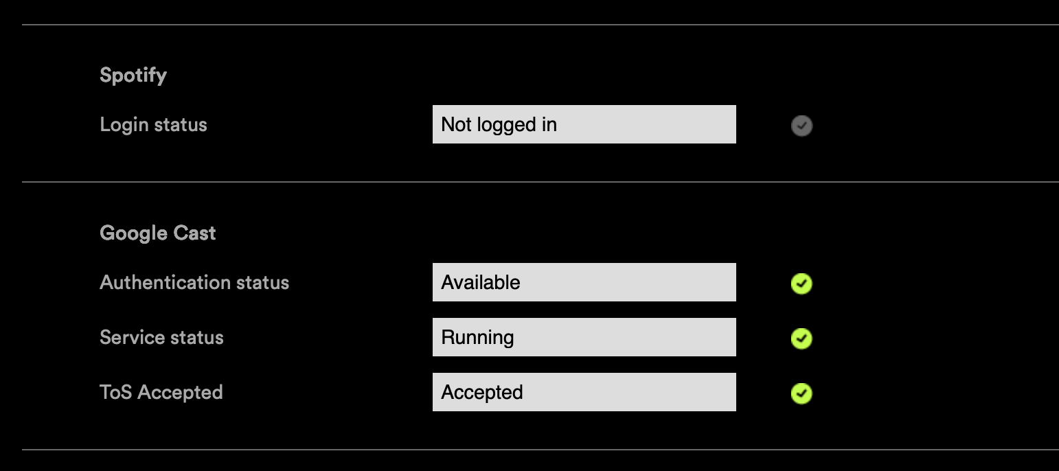

The diagnostics page displays ‘not logged in’ for Spotify status, but there is no way to log in right? I certainly never had to do so.

There is no logout option, only ‘Input Enabled’ (tried that), ‘Spotify Bitrate’ and ‘Gain Normalisation’. And ‘Open in Spotify App’.
