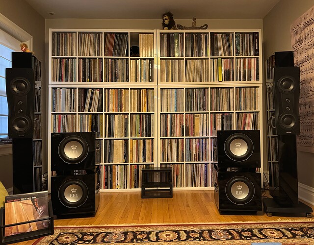

Stacked RELs are more than just multiple subs. They are configured as a line array, Each level in the array has a different role and is configured specifically for that.
I have a four-pack of REL S/510, i.e. two pairs, with a third pair on the way to complete the six-pack. There is plenty of information about it at the REL website.

I should have checked …
Looks great JDP!
