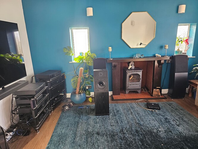

Hello - I think but not 100% sure, but both of the tweeters have gone in my SL2s.
The last time I listened was midweek and they sounded great, Saturday night, completely off. If I disconnect the cables going to the bass unit nothing comes out of the speakers.
As far as I’m aware we haven’t had a power cut or anything. The system is turned on all the time. Does anybody have a plausible explanation?

Good ideas. I’ll rebuild the lot. I can remove the innuos phoenix and mscaler too, it’ll work without those boxes. If the rebuild doesn’t work I’ll get the SBL out of the loft. I did try swapping out one PAXO, that didn’t make any difference. I’d almost rather it was the tweeters than one of the big boxes failing in some way…..will update in a day or two. thanks
unplugged everything and back again.
Still borked. I got a single SBL down with ropes and yeah, the tweeters are blown. Its all very strange. The 552 mutes on reboot too so should have protected if a transient power cut.
