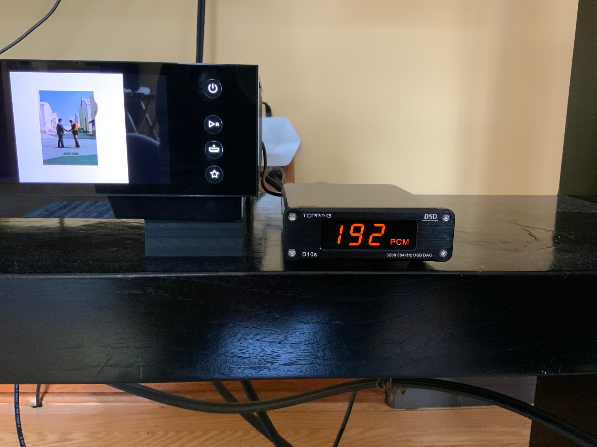

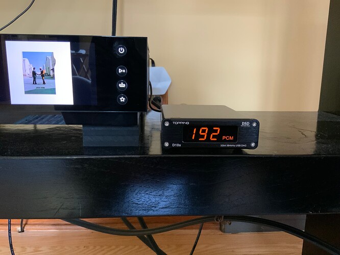

Ah…my stumbling around is yielding some…something. (Though I never found exclusive mode.) Lol. So. With Apple music the output from the Mac Mini M1 is set at whatever you choose (192/32…) And whatever you play in Apple music shows on the Topping D10s as the rate you set (I chose 192/32). But. After playing with the Qobuz app and allowing it to control my Mac, now, when I play through the Qobuz app, the different rates DO appear on the Topping, unlike when using Apple Music.

Sheesh. OK…if I choose a song from an album using the Naim app the Topping display remains what I have the Mac set at. But when I play that selection through the Qobuz app then Topping display changes to reflect the rate.
When I play through the Naim app the sources indicator isn’t lit showing a choice. When I stop the selection in the Naim app and go to the Qobuz app and play the same song, the display on the Topping does, as I said, change to reflect the source rate, and though the selection is playing there is no sound. You need go back to the sources and select the digital input for the Topping. Then you have the sound and display once the source is selected. I have the Topping in Digital 3. If I then go back from the Qobuz app to the Naim app and play, the rate I selected in the Mac settings again displays regardless of source. And then the “digital 3” source tab is no longer lit.
Ah…another thing, when playing Qobuz wired through the Toppping our lovely screens no longer display artwork…just the source selection (digital 3 for me)

And as for the way I’m doing it, I want to see the rate on the Topping…

Caveat: when playing through the Mac, the artwork is not shown. The Topping there is merely displaying the last source I cued up. Now I’m streaming from my iPad. When using the Topping the display says “Digital 3 (or whichever you use)”

Sure, have been. One thing cool with the Topping tho is it displays the Qobuz rate when played through the Mac. I like to see the rate. Another thing, I’m wondering if accessing Qobuz through the Naim app (as in clicking Artists with the Qobuz logo in the Naim app) plays hi res? The Qobuz app defaults to the source and I choose my Naim, and then the screen shows “Chromecast built in” *when accessed through the Qobuz app. When I play Qobuz content through the Naim app that screen (Chromecast built in) does not appear.
