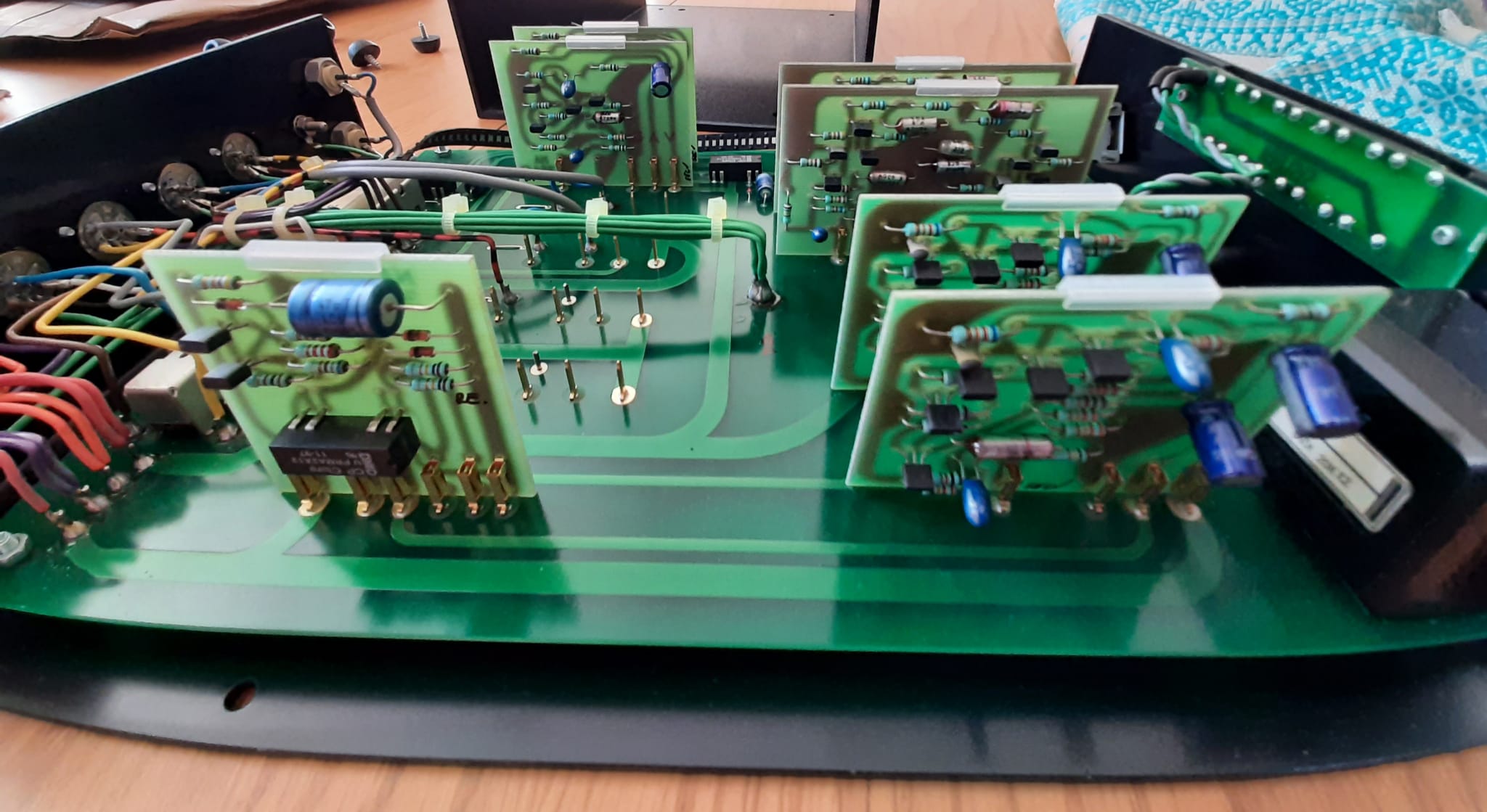

The situation is as follows: I was prepared for the '72 to be full of dust, well I’ve had it 30 years and it’s very well travelled. Nope, it looked clean ‘as new’ inside, amazing!
As well as the feet there is a dome-headed hex-bolt at the rear of the casing. That was as stiff as hell, I considered the wisdom of using a bit of very brief force trying to remove it. …Allen key held by large pliers, one jolt and it moved. There is a toothed locking washer with this bolt that had a touch of rust on it.
There are 7 PCBs inside:
2 * NA324/7
2 * NA 729/1
1 * NA 325/7
2 * NA 321/5
Nothing in the phono slots or boards marked 322/323.

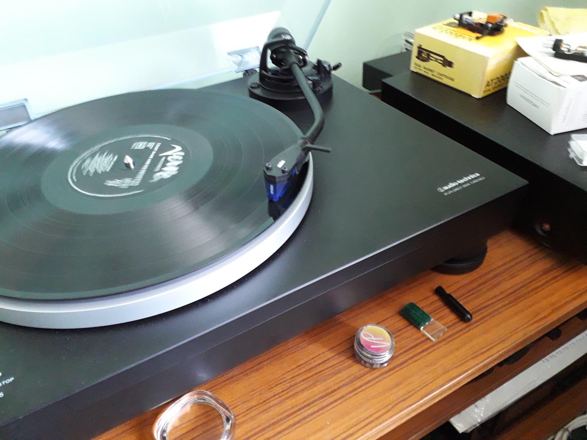

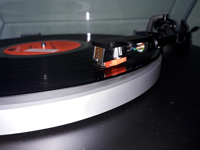

Hi there, if I may come in on the back of Jonathon’s suggestion of the AT- 120. A few years ago my father owned the AT-LP5 and this was a fantastic budget player. The point is that it was so versatile as a different quality cartridge could be swapped in within seconds. An instant upgrade without having to change TT or break a budget. I am sure the AT 120 will be super value for money, and as Jonathon said is quite a looker ( Technics vibes).
I will end by featuring a couple of photos showing how well the deck can be upgraded
A Ortofon Blue cart, and
A vintage AT cart from the late '80’s
Good luck with your choice.
Ps The AT 120 comes with a more than capable cartridge fitted.

I thought it might be useful to add an image of what internal boards my '72 has in situ. I took a dozen or so pics of the individual boards and from different angles. If further clarification would help I can likely post an image to answer it…
Nice. Does look like it’s been serviced.

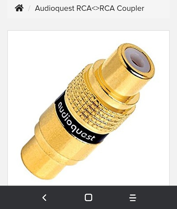

Pretty sure you can use one of these.
Or you can use your intended cable with two of these.
So you get the choice:
