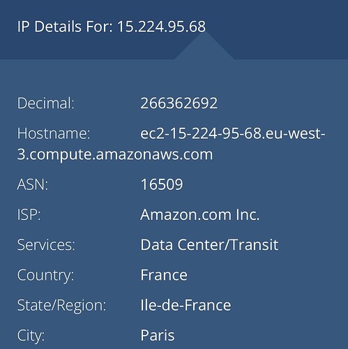

I can See outgoing Traffic to 15.224.95.68 Port 8089 If i select a Radio Station..
The Main Menu does Not load at all any Radio stations and After a Time period Access to Server denied Shows up in Display ..

Seems to be an Issue at the Data Center where the iradio Service is Running.. that explains the error Message: Access to Server denied..
please, dear naim Team, can you Support here and escalate to your AWS Service Provider?

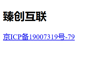

Also one other thing to check is that from your PC / computer of choice browse to:
http://radioeu.naimaudio.com:8089/
It should show our Chinese registration ID:
ff it does then the server is accessible from your location.

I tested your provided link on my mobile phone using the same Network Connection the Superuniti is Part of.. and yes the Chinese Page opens..
