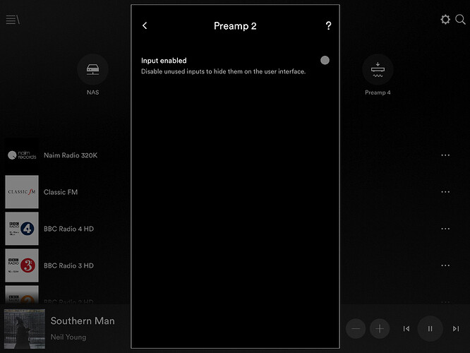

Thanks PCD. Here’s what I see in ‘Input Settings’
Where would I find if Preamplifier Input 1 is enabled? I’m guessing it must be as I’m playing the NDX2 through it and hearing music!
When I enable system automation and go back into input settings I see this for input 1 - no option to enable.
As opposed to the other inputs which do have the option:
