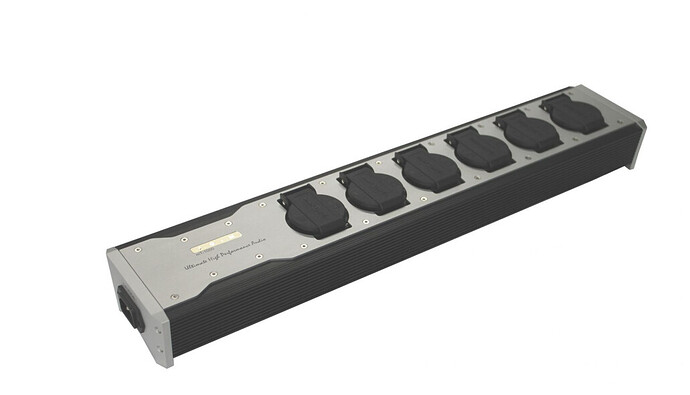

Opinions vary, as with anything hi-fi. The Puritan PSM156 block has some strong supporters, and not at too a silly price. Perhaps get one on sale or return? Only your ears can decide if it works for you. There are of course many far more expensive solutions from Shunyata etc.

Anyway, after trying many good ones, I now have 2 of these at home, one for each setup:
The SOtM MT-1000.
