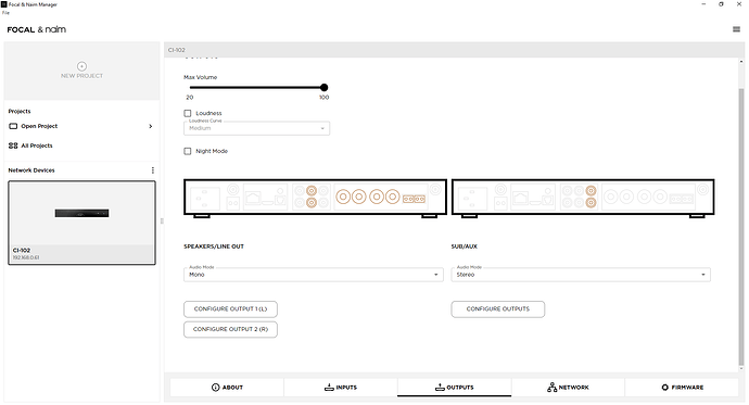

The ‘Outputs’ selection tab window (note that I did not show this window in my previous postings) appears like this:-

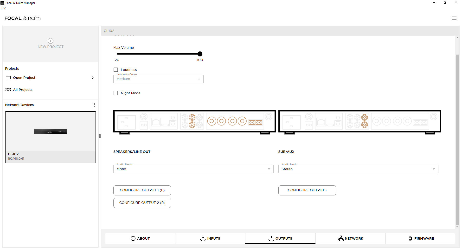

The next step is to select the ‘Configure Outputs’ button for the Sub/Aux RCA outputs highlighted in ‘brown’ colour on the diagram (maybe that colour is meant to suggest ‘Gold’?)

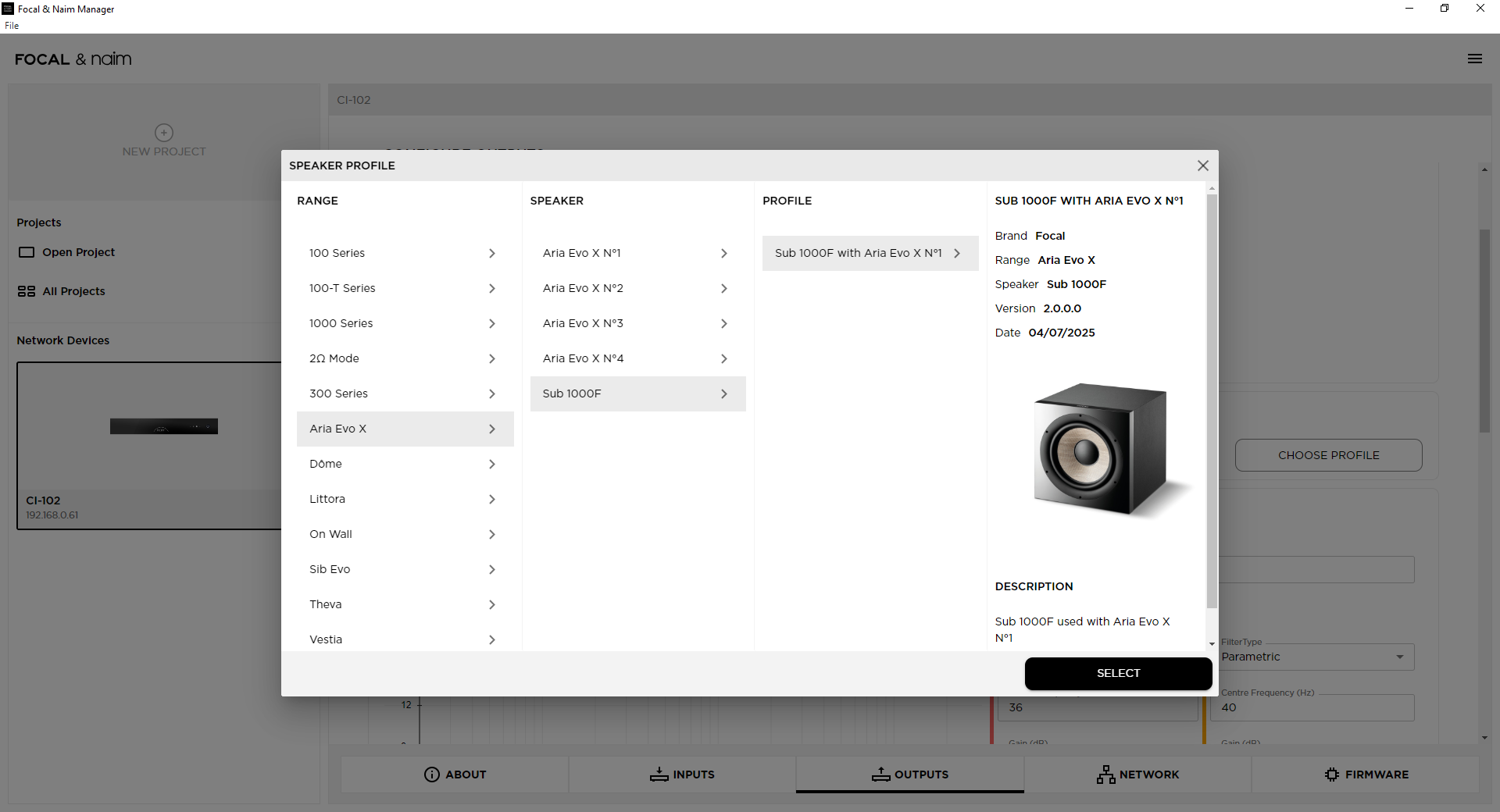

Again, as for regular loudspeakers in the Focal-Naim manager software, one can select from the availble range of Focal Sub Bass products. Here is an example…
Needless to say, as before, I just bypassed that setting!

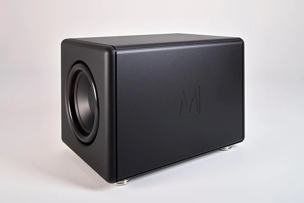

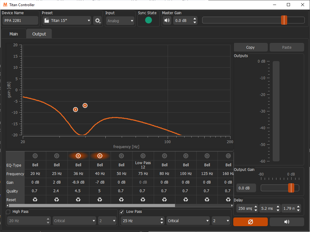

The Magico Titan 15 Sub comes with its own built in DSP Equaliser with dedicated control software. I am still optimising my settings for this, but nevertheless had established a reliable set of workable EQ values, the control panel ‘Output’ tab of which is shown here…
For the experiments with the Naim CI-102, I turned off all the Magico EQ (apart from the time delay correction) and set the Titan15 for full bandwidth with 0dB gain.

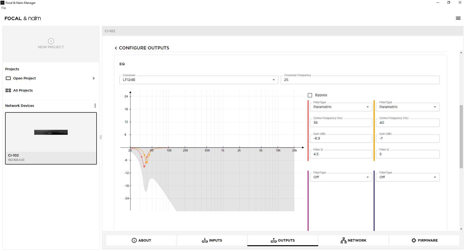

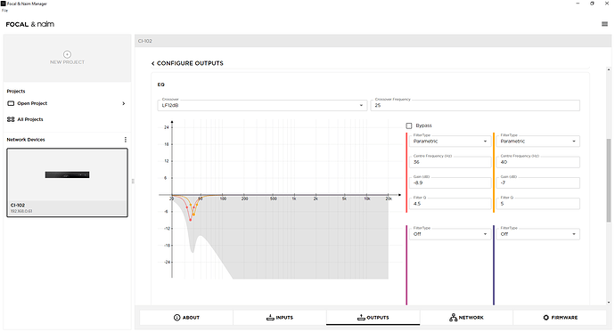

Then I set the Naim CI-102 software for the Sub/Aux outputs to give the same EQ settings that I had established previously with the Linn SO and Titan 15 together. Here is the image from the control window in the Focal-Naim Manager EQ Software where I set the relevant filter parameters for the Sub/Aux Output.
