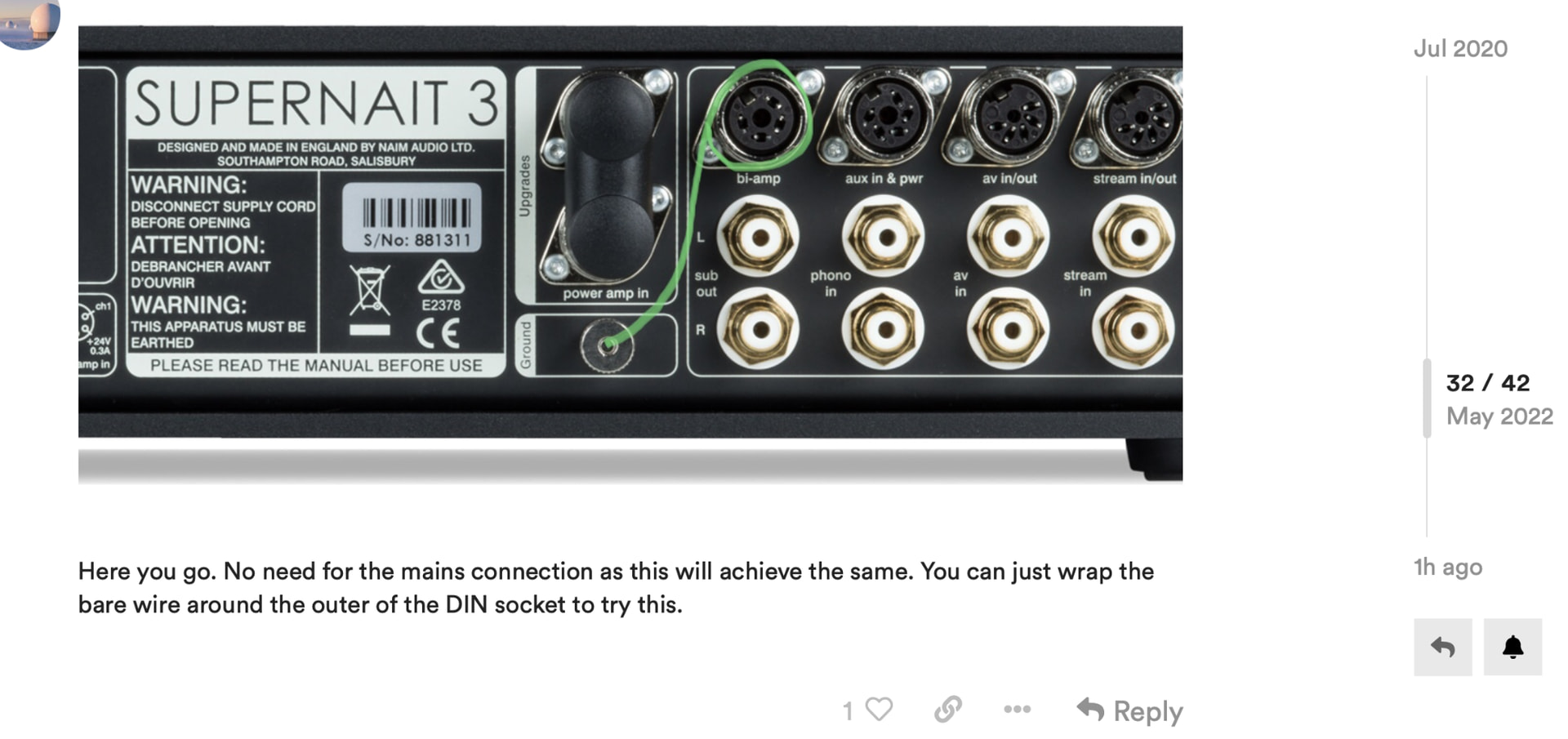

Hi guys, has anybody with non Naim source/DAC experienced any humming/buzz noises with the N50? Recently I have been trying a different DAC, until now with my nDAC I had 0 hum, regardless of the volume level, but with another dac, a R2R ladder DAC in particular, there is a hum when I turn the volume beyond 12 oclock, with no music on it is pretty audible. Previsously, many year ago when I had an SN2, James_N suggested the following grounding DIY method, which seemed to cure the problem. My question is, can similar connection be applied with the N50? If yes, to which DIN socket?

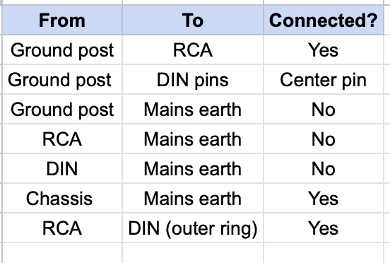

It should be connected already so I don’t see how it would help connecting them. At least on Nait 50.
assume the R2R dac is unearthed? if so try earthing that to the N50 ground maybe
Yep, tried that as well, I have an LPS even attached to it, a good one, makes no difference. I am maybe inclined to believe that there is probably an issue with the device, so just wanted to try every possible scenario before making any final conclusion and packing it for return to dealer.
