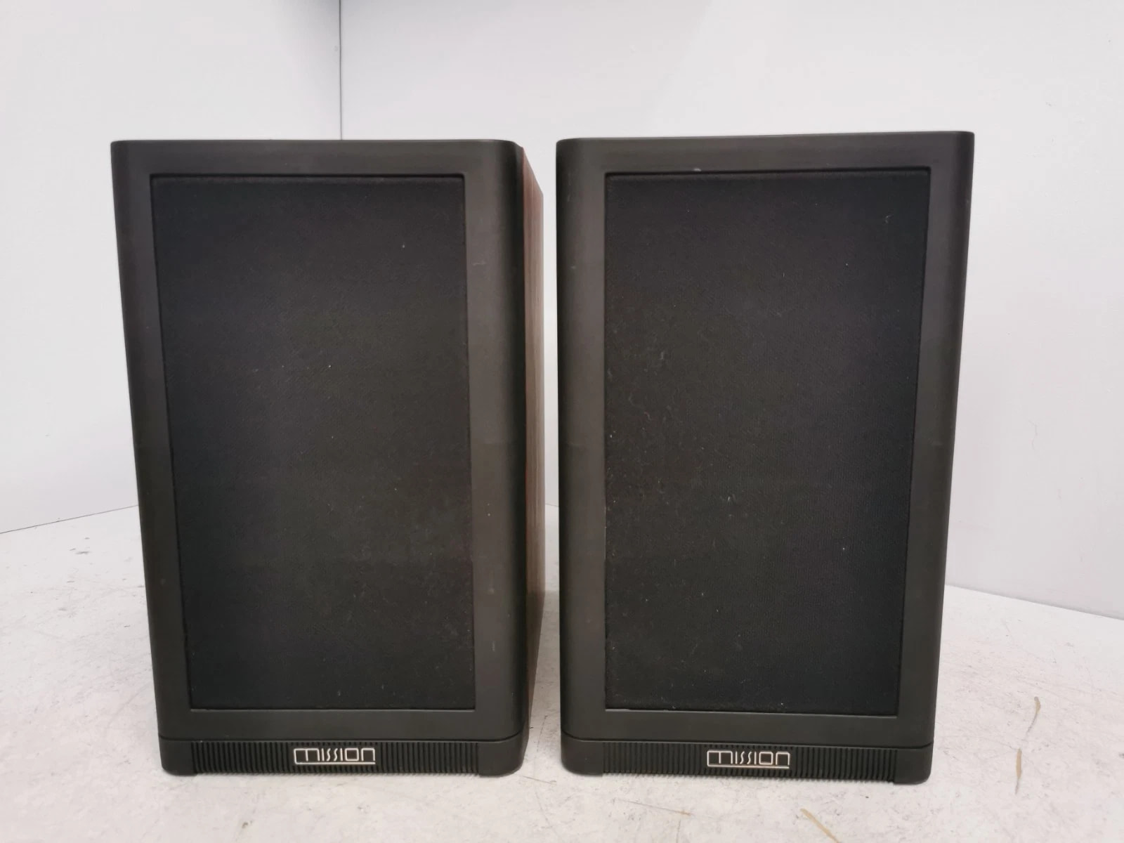

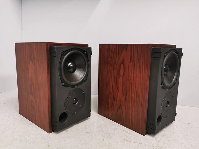

Having looked for the last couple of months at Kan’s and Naim speakers, IBL and SBL but not having been able to make a decision (some of them being pick up only and too far away, some no or questionable history re. modifications from owners after I have approached them), I watched HifiRiffs emphatically positive YT video, made some 2 months ago of Missions 780 vintage stand mount from the early 90’s. They loved it.
I am a self confessed Mission fanboy (752 F’s in use) but could do with a smaller speaker with relatively tight bass to pair the N50 with. So I thought I’d see if there are any half decent ones on the bay and found this one, newly listed today I believe;
Cheap and they seem in fine fettle. I have no problem doing a little refurb and change ferro fluid/replace Xover parts if needed. I paid slightly over the odds at a hundred quid as they apparently go for slightly less but this is the SE in lovely rosewood (as my 752’s) so I don’t mind.
Being Missions I hope they preserve the drive and PRAT inherent in their earlier speakers. If not, nothing lost and the search for (probably) some Kan’s will continue. These little Missions have always been budget speakers so I do not expect miracles but David and Mike seem to compare them to current PMC speakers/Prodigy so they can’t be that bad either.
