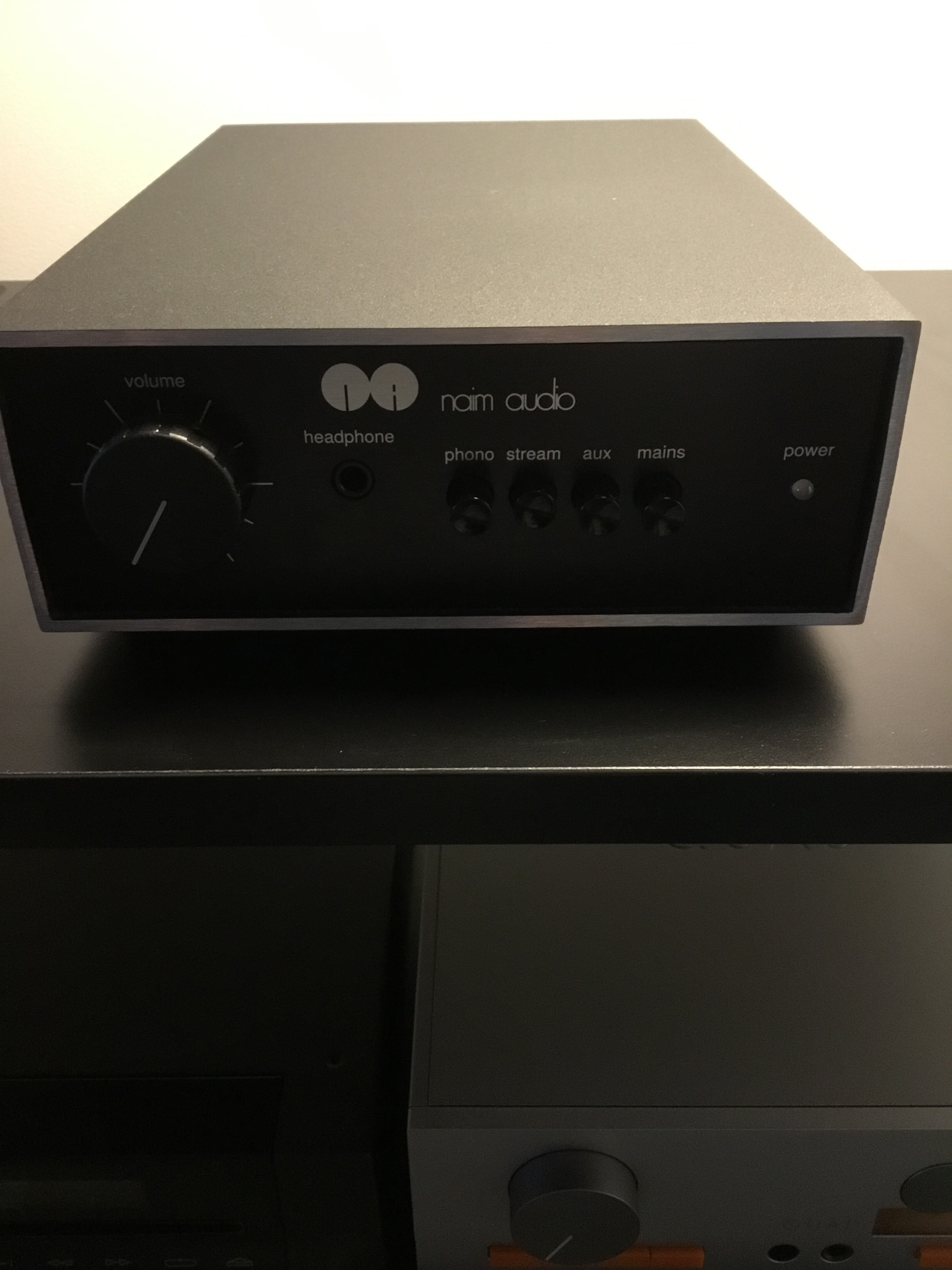

No TT connected. Streamer ( nd5xs2/ndac) is my only source in this setup. Only pressed phono inpt by mistake today and noticed the crosstalk.
Don’t press phono
It’s because it isn’t loaded.
If you connect a turntable and complete the circuit sorted. :+1:
I recently had the same thing… accidently selected phono and, although I didn’t notice any crosstalk, I did notice a loud humming. Got some rca shorting plugs at Amazon for peanuts money (8 pieces for less than €10,- incl p&p) and it’s now quite as a mouse. (only not selecting the phono input is cheaper) :wink:
I’m sure connecting 2 of those shorting plugs will solve your crosstalk issue!

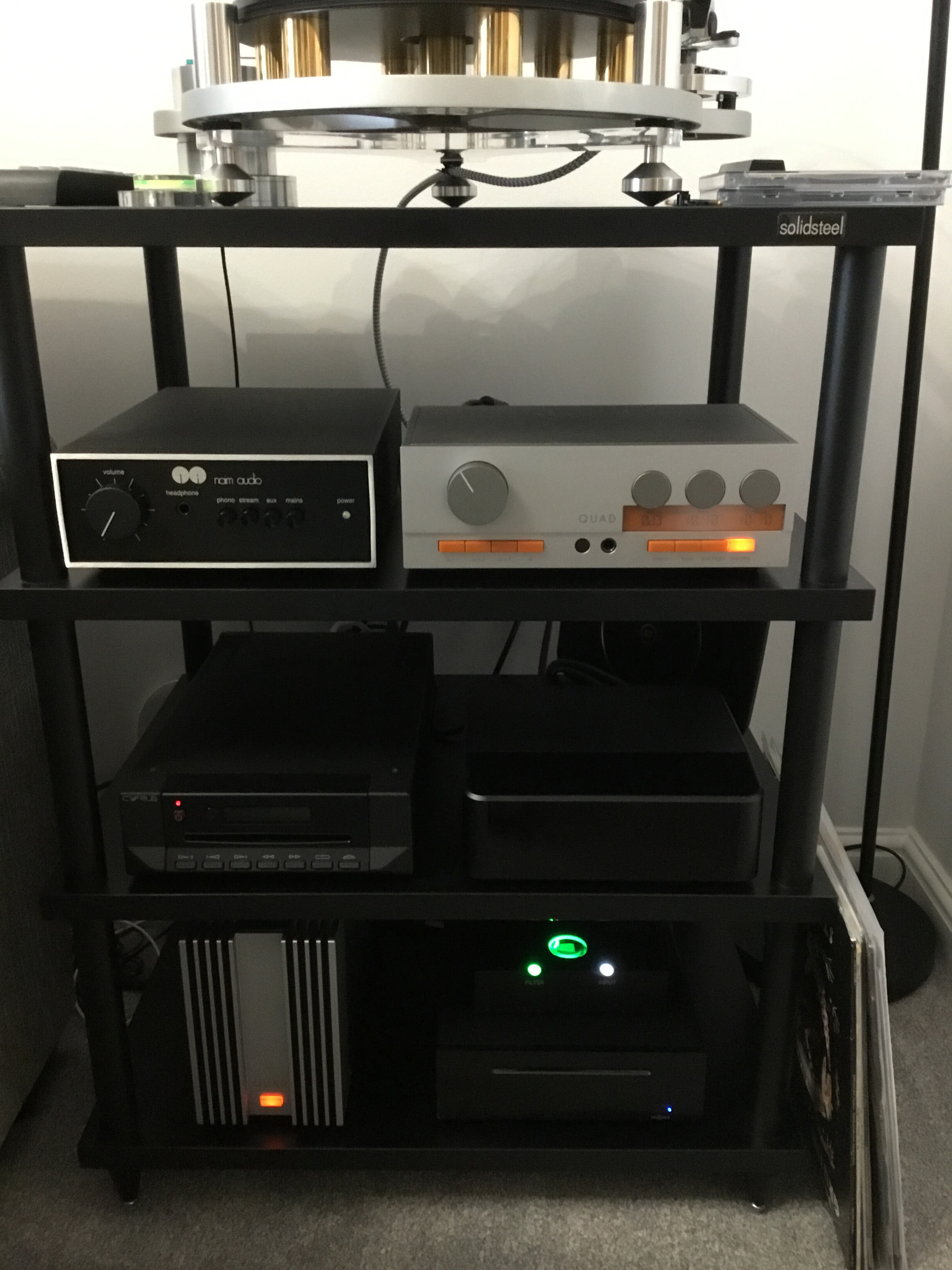

My Nait 50 is coming back into the system after a few months hiatus, the Quads moving on for now.
Thats a very nice setup you have there, the Nait 50 is rather special I bet it sounds great with the Qutest and Gyrodec
