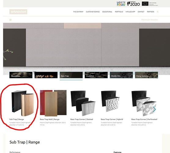

If the goal is to target the lower end of the spectrum, GIK products are not the best choice. Far from it…
I would recommend something like Artnovion’s Sub Trap, or equivalent.

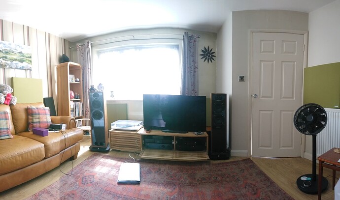

Well they arrived this configuration sounds best
2 x traps at 1st reflection point and 2 x traps placed behind speakers, these have built in scatter plates.
Happy with timing. Now onto the bass.
And mrs spb doesnt like the colour…dou😬
Soundstage narrowed but much more focused
Yes I got that.
That right speaker is pretty tight against the TV and wall. Just some thoughts (putting aside cost/furniture changes!):
1 Could you reduce the 3 cavity unit under the TV to two? It’s this unit that is forcing the speaker placement.
2 Re-site the record player and whatever is in that third to the left of the left speaker
3 Shift the TV more to the centre
4 As a consequence, give the right speaker a bit more room to breathe?
It’s a good call! I can’t move my seat more to the left as there is a doorway into the next room. and it’s currently roughly equidistant to the speakers.obviously if I move the speakers to the left it will upset that. I did find moving them forward so the baffle is in front of the wall with the door on the RHS made a huge difference.
One day soon I will take the TV out all together and make some measurements. Throwing a douvet over it makes absolutely no difference to the measurements or to my ear, however packing behind it with cushions did and that led to the 2x traps behind the speakers!
