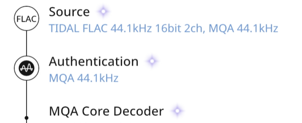

See
“WHAT IS 16-BIT MQA?”
and
One of many forum discussions on the subject, this on the Roon forum, where the Roon Core makes the 1st unfold of the MQA encoded material and presents MQA 44.1 as a 24/88.2 stream
