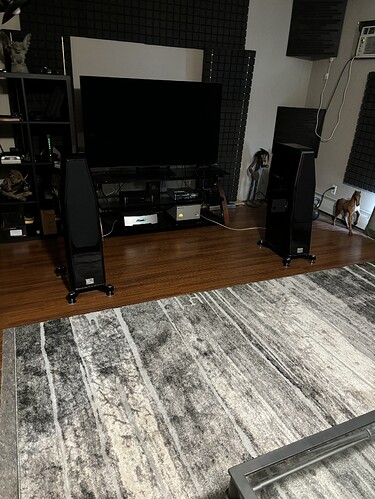

What happen when you move the speakers forward in the room and perhaps a bit closer together?

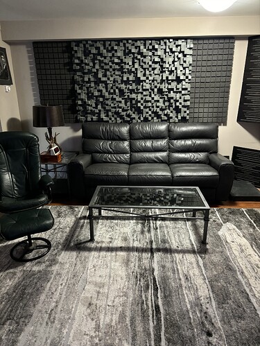

I would not cover those tiles with another type of flooring myself. Why not just look around for a bigger rug with underlay? I did this last year in my apartment, lots of options out there.
FR, didn’t you have some kind of butcher block under your speakers at the old place? Is there a reason you are not using them in the new room?

I tried different positions, giving more space for the left speaker improved things.

Rug over tiles here. With a thick felt underlay it made a decent difference.

An even better solution if you can get it by the design committee, is to add some proper acoustic panels. This would have a far better impact on sound & if done properly wouldn’t need to worry about what’s on the floor. Adding a thick carpet, drapes, etc just removes the highest of frequencies, this is not what you actually want to do.

I’ve had both types of floor FR. I think tiles are okay and perhaps can be best as long as there is something to dampen the early reflections. I notice your carpet is longwise (I have the exact same IKEA carpet BTW and had it in front of my system for 10 years - it’s in the hallway now). Sideways to actually cover the area in front of the speakers would be my preference.

Are your speakers placed close to the wall previously? Personally I would push the speakers out from wall boundaries. Rug will make a difference but it won’t be significant unless you pick a thicker one, and a larger piece. Instead of 1.7m x 2.4m, go with larger 2.0m x 3.0m or 2.5m x 3.5m etc.

The left speaker more to the right, and both with more space vs the wall. Better.
