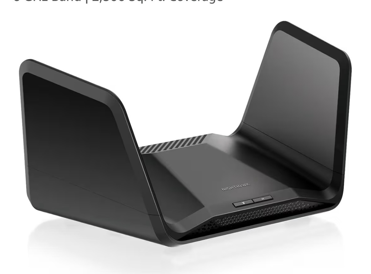

When we had Plusnet we could never get Mesh to work properly. We tried three different mesh setups and gave up. We bought a Netgear Nighthawk RAXE 300 router, and put the Plusnet box into modem mode. The router is really powerful and covers the whole house and the back garden.
We then swapped to full fibre in autumn 2024 and kept the Netgear, which connects direct to the fibre ONT wall box. So if you ever get fibre, it won’t be wasted.

@HungryHalibut The Netgear Nighthawk RAXE 300 router seems to be quite an old model and only available 2nd hand. I assumed replacing the router wouldn’t be the answer as the I assumed that the coverage would be about the same which is why I was looking at mesh rather than a new router - or have I got that wrong too?
