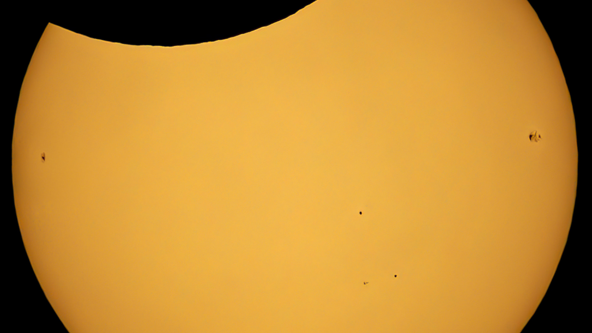

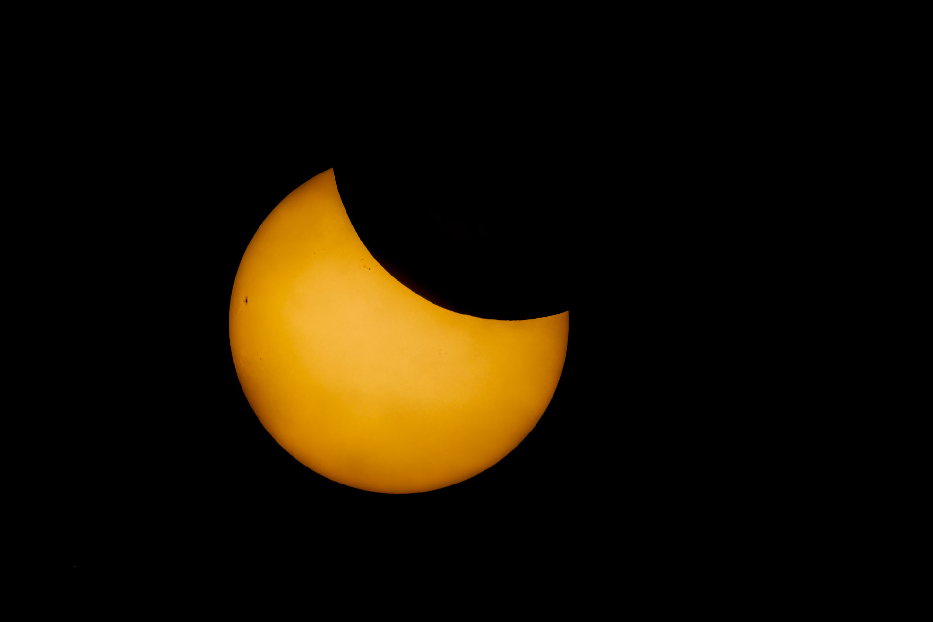

March 2025
October 2022
March 2015

Do you have any tips please on how to achieve the quality, especially October 2022 with the very clear sunspots?
Ideally the longest lens you have, then putting the camera on a tripod and shooting remotely (via camera app, remote button or timer, whichever you have/can use). Use the screen on the camera to view.
On this occasion it’s going to be in the evening and the sun will be relatively low in the sky, so being high up or on open ground will be useful…Being low in the sky, there will likely be a bit more atmospheric and pollution haze too, which won’t help.
Then, I suspect what a lot of people forget is that The Sun and Moon are travelling really quite quickly across the sky! Even though the distances involved suggest otherwise…
Which means a reasonably fast shutter speed at say 1/800 minimum is a good idea, f/8 means that everything will probably be as sharp and in focus as your camera/lens can make it and then whatever ISO is needed, depending on how dark it gets.
Now as it gets darker on what will be a full eclipse for you then you will need to adjust these but as the partial starts, the above should get you going. I have no experience of a full eclipse so can’t help you much as you approach totality. Google may be your friend here.
I have used dark filters before but I have found that with fast shutter speeds and an obvious and reasonable amount of partial, the amount of light hitting the sensor hasn’t damaged anything so I don’t bother. Plus you then need a slower shutter speed, wider aperture or higher ISO, none of which help much in these circumstances. Pointing directly at full sun with no eclipse may be a different experience!
Oh, and then you need to edit the pic to bring some colour back in, because otherwise it will be very white.
