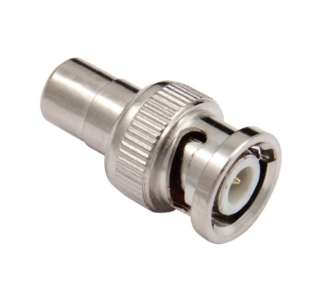

Buy a couple of BNC to RCA adaptors.

The only issue with adaptors is that they are a performance compromise compared to just using BNC plug and socket (yes, many years ago we tried at the factory and every time the adaptors were easily heard). By all means use them as a temporary stop-gap (useful here, but note that they can deteriorate with age and use) but if you stick with them then just know that you’re missing out compared to going BNC plug and socket.

Splendid idea! Thank you. That will do nicely until I can source a suitable cable.

Thank chaps for all the advice. I now have a suitable set of bnc adaptors and three arms (all with captive leads) to audition with my 82 pre. The winner will be bnc retro-fitted to avoid using adaptors :+1:
