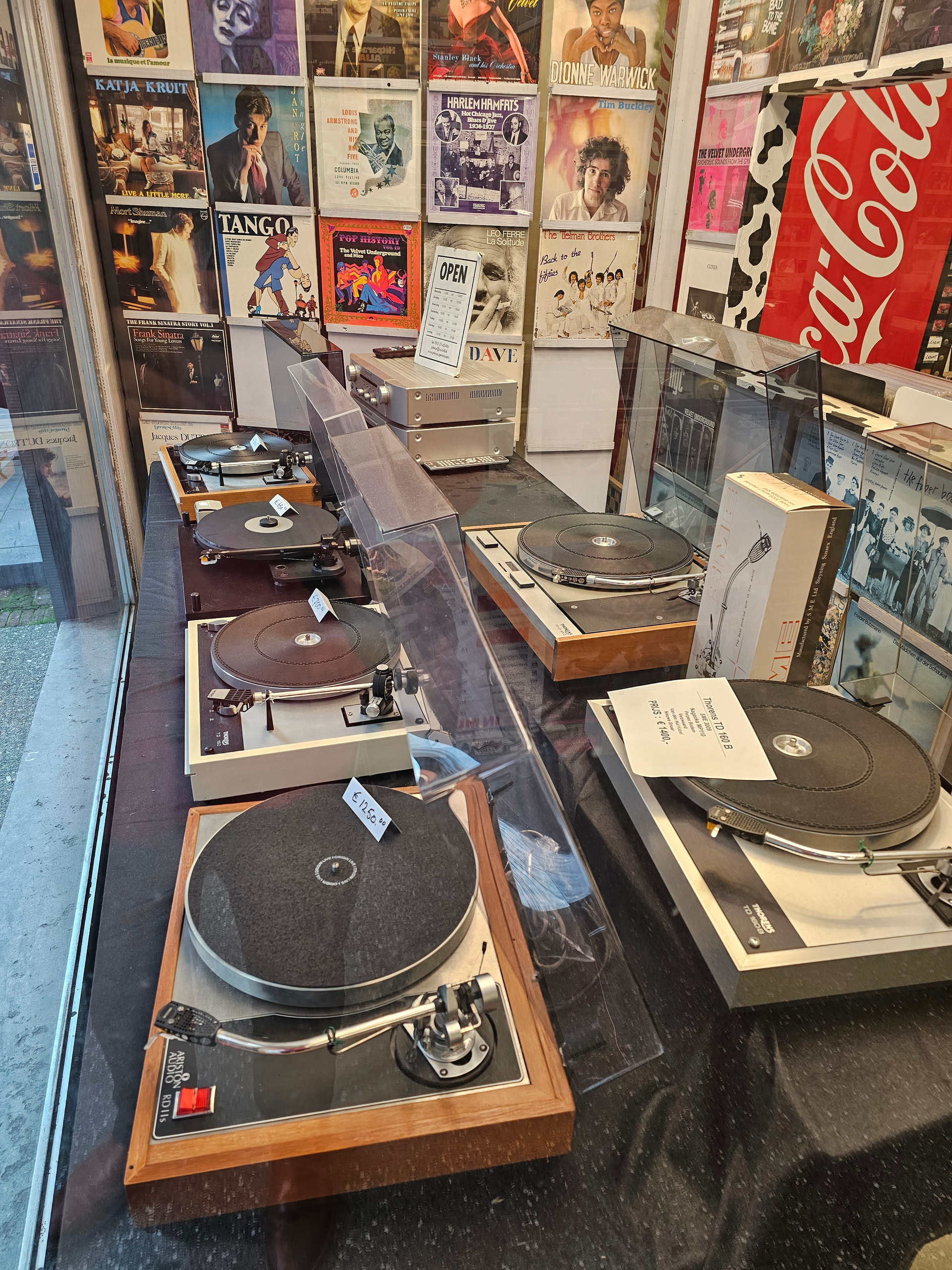

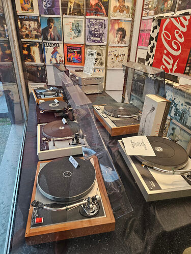

At least 2 decent record shops in Delft when I was there last month. One had a decent selection of second hand TTs too.
