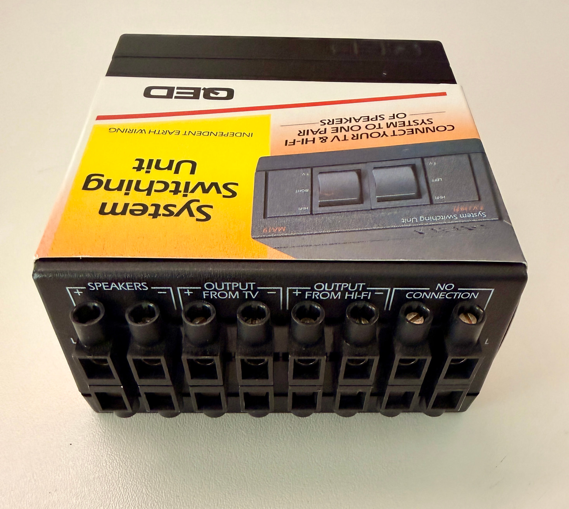

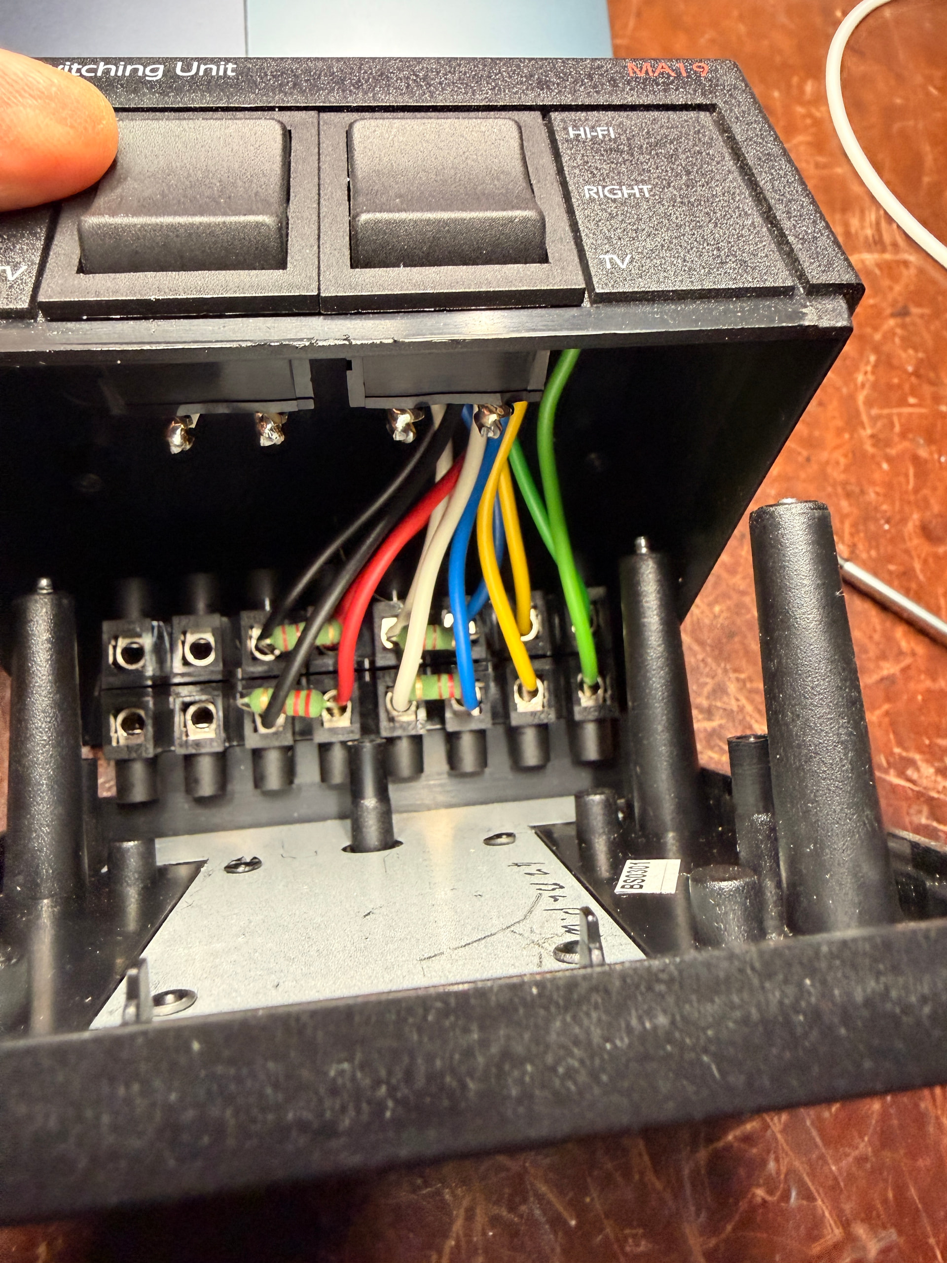

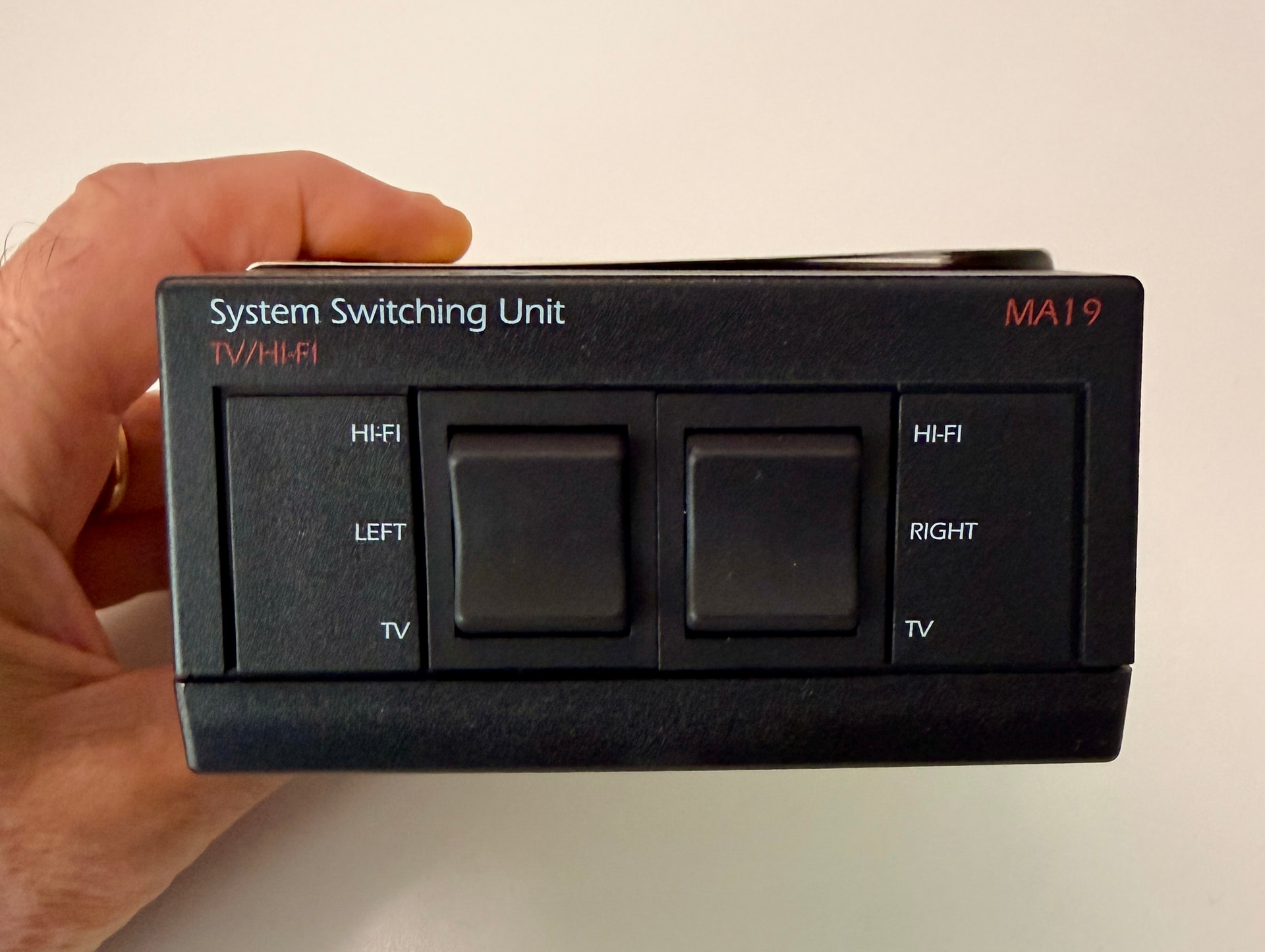

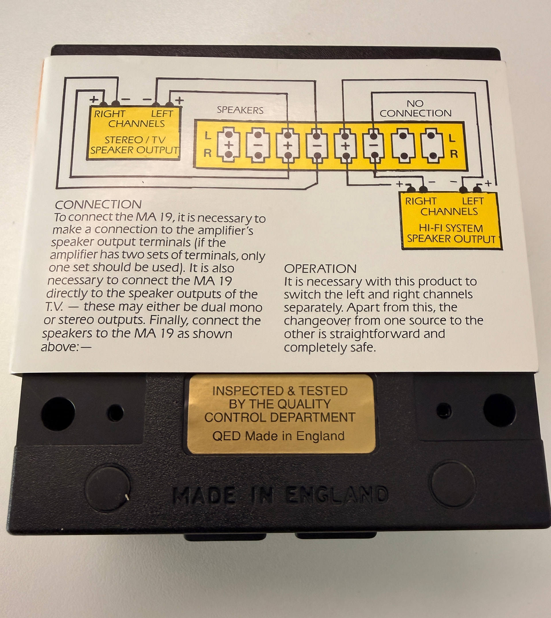

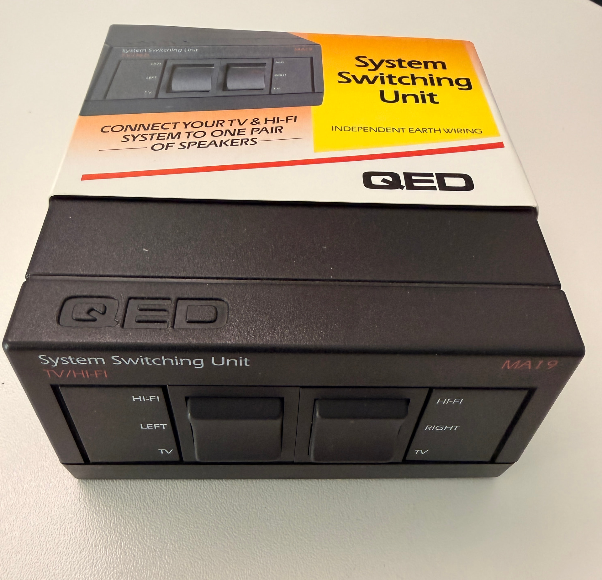

I think I may have found the best possible solution. Looking in my stored vintage stuff, I have found this wonderful and well made QED MA19 switch I bought 45 years ago and never used. It is sturdy and guess the connections inside are made of quality components like they used to make then. Maybe I could change the screws that secure the cables with new silver plated for better contact.
This QED indeed looks like quality stuff.
