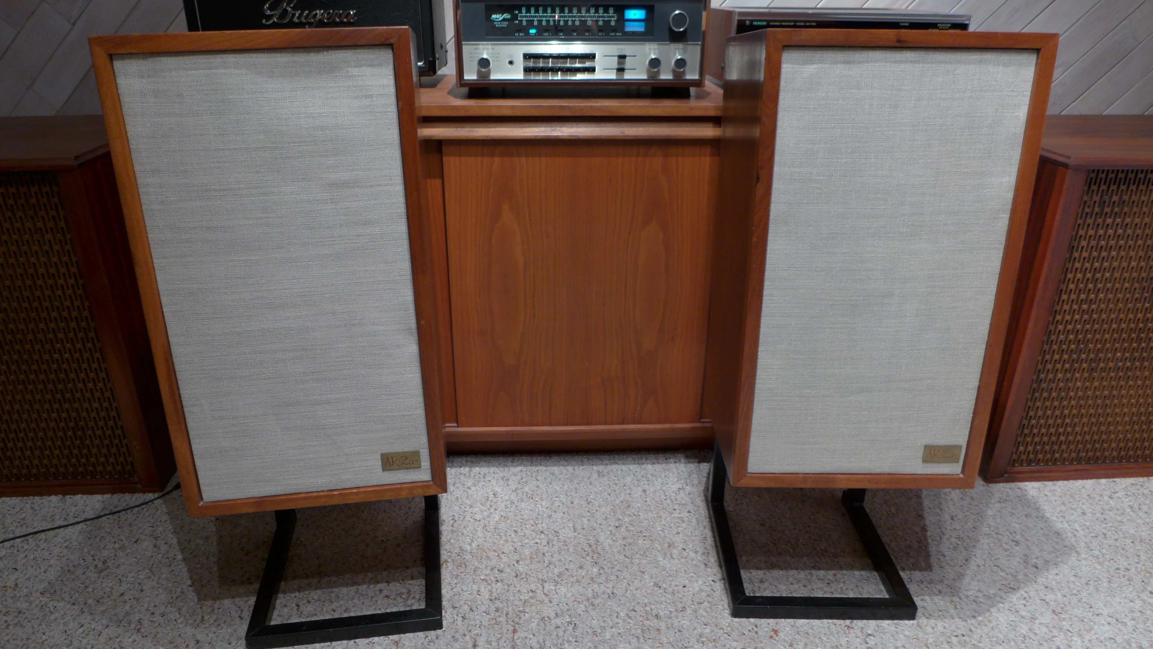

Thanks for the responses so far; looks interesting. Definitely need to do some research here. Some early browsing has turned up some options like these:

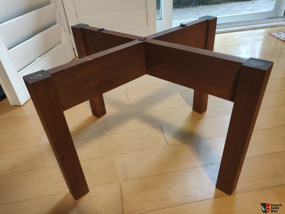

Or custom jobs like this:
Think it will come down to pure fit, but those open black metal stands look to be a halfway decent option, although not the best looking to my eyes.
Keep searching. There most definitely are official JBL stands for both their L100 sized speakers and L82 sized speakers and equivalent. Low. Open frame. Low mass. Tilted. Obviously they work with any large speaker of a similar footprint.
