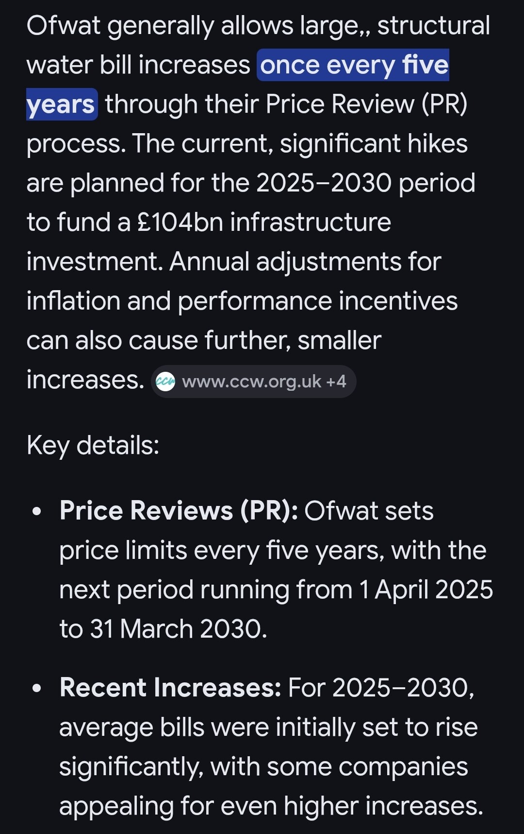

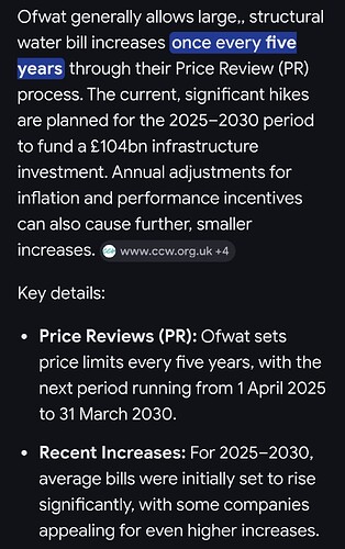

It appears that ofwat allow a large increase once every 5 years. My bill also went up about 25% in 2025, but increase should be dependent on inflation. Hopefully.
