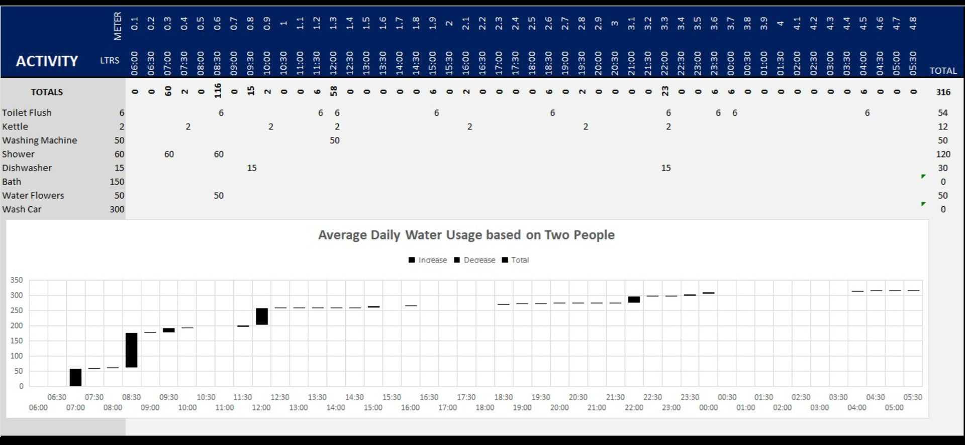

It’s called ‘short interval control’. Something I use to do regularly in manufacturing and the results were always surprising, and nearly always isolated the problem.
I know it’s a pain in the butt but you can draw some very clear conclusions once the evidence is in front of you.
I’d first list out all the activities that use water and ask AI what is the average water consumption for each activity. Then I’d run a ‘typical’ but hypothetical days usage for Mr & Mrs Joe Average, then I’d run my own (accurate) usage and look to see where it deviates?
If you are spreadsheet literate you’d have 30min time intervals for 24hrs on the X axis with meter readings and on the Y axis you’d have activity list and LTR’s used. This would paint a very impressive picture that might help strengthen your case with the current supplier.

I couldn’t resist putting together a quick (imaginary) spreadsheet based on the average water consumption for two people sharing a house. I don’t get to mess with Excel as much as I use to, so it’s good to get some practice. This is what it could look like…
What was interesting was that AI quoted basic consumption figures on modern day equipment. It was very clear that older equipment could use up to three times as much water. Things like dishwashers, washing machines and old toilet cisterns were the main culprits!
