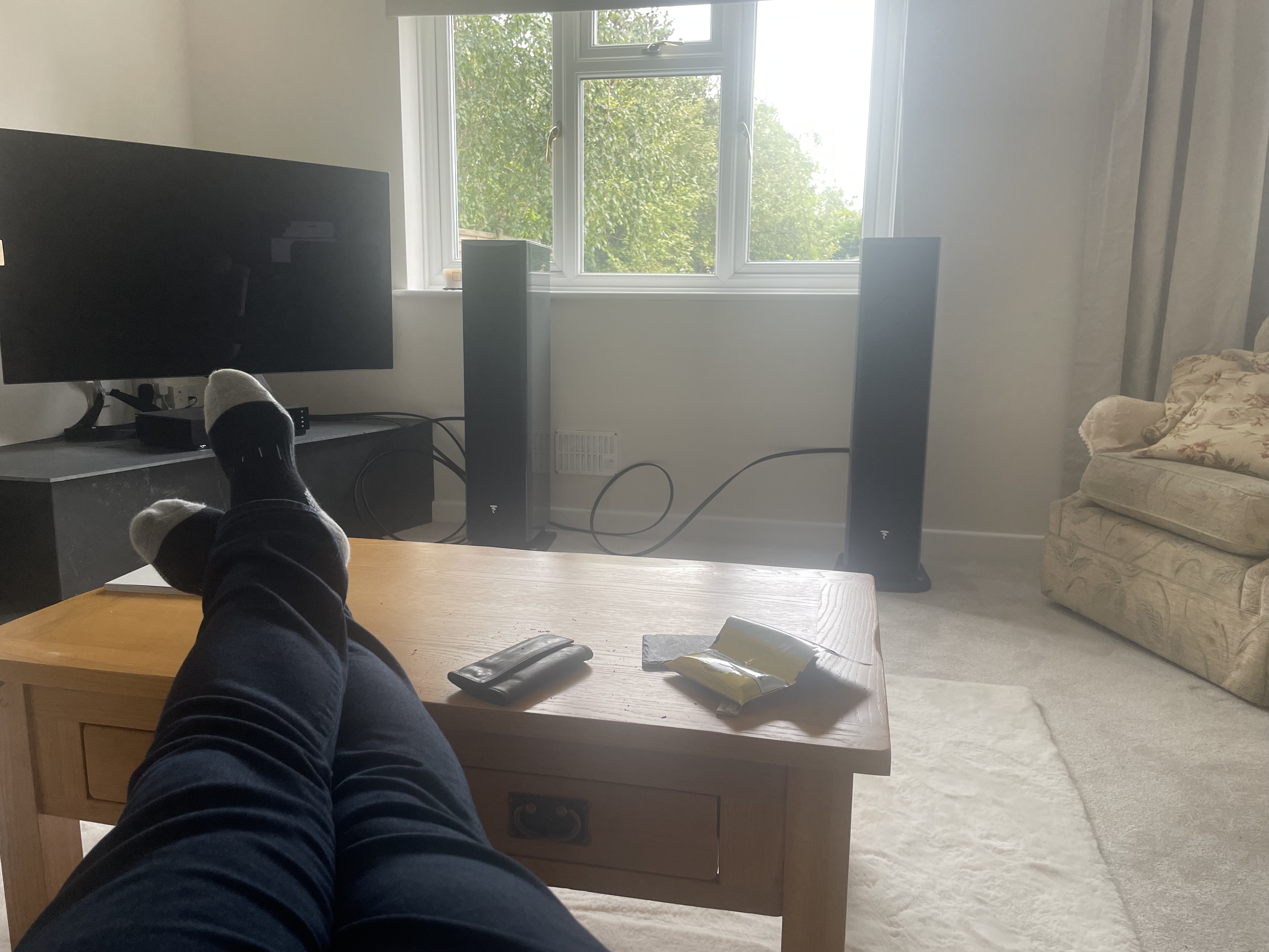

Hi @TomW , some questions I think haven’t been dealt with above:
  1. do you have a photo from your listening position? There could be reflections and bass issues going on.
  2. how far from the speakers are you? Focal recommend 3m.
  3. Is the tweeter bang on ear-level?
  4. What are you using on the base of the speakers, the aluminium base with spikes?
And some comments from my experience with the Focal Aria (albeit 906s): the Arias can go closer to the wall than 0.5m. I found 0.35 was optimal with my 906s in my room and it smoothed them out a bit. They didn’t need much toe-in at all (and depending on your room and listening position, you may choose no toe-in which could help with the perceived harshness as they won’t be firing directly at your ears). Do let your cable, Nova and speakers run in.

@JamesBKK is bang on regarding positioning and preferably a photo.
I own focal speakers, and the match is difficult to make, but when the match is good they produce an interesting and addictive sound. But the room also has always something to say on the final result.

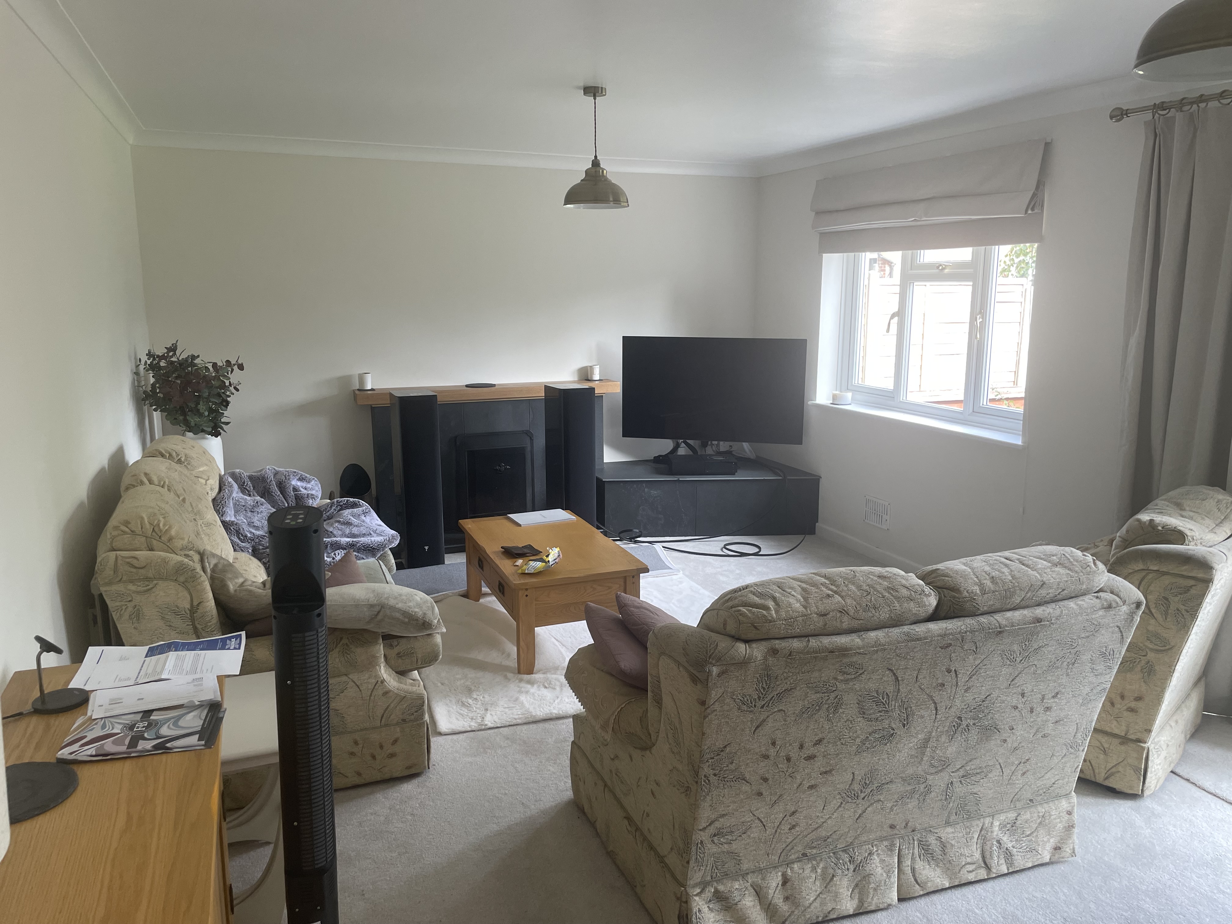

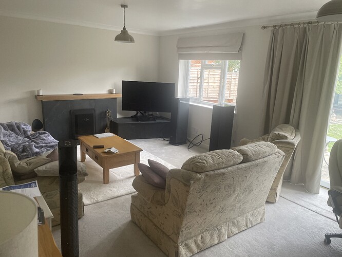

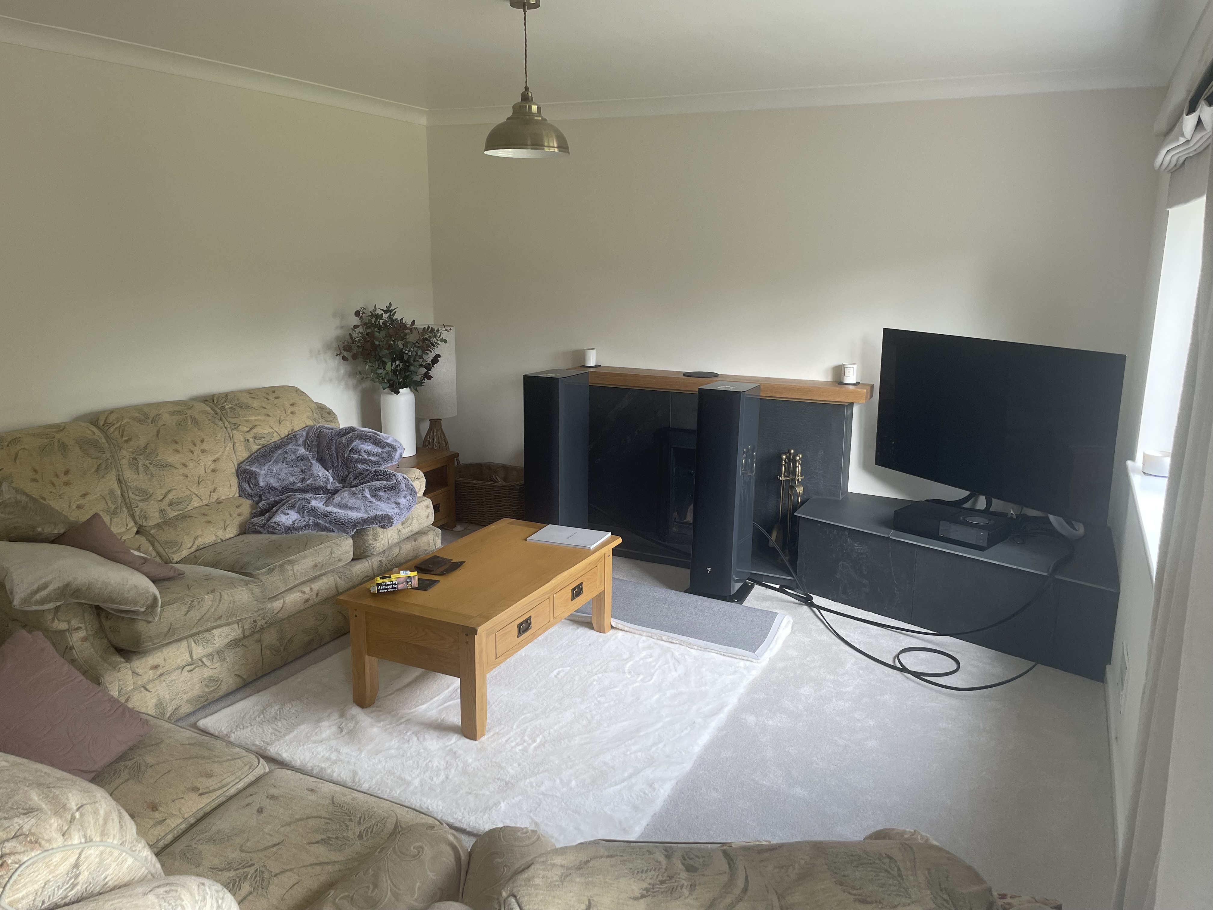

Difficult one with the room layout but my gut feel is you need to get more width between the speakers somehow. Maybe put the single chair between the speakers to get them further apart as a trial?..
I agree you need more distance between the speakers, try moving the single armchair behind the couch as an experiment and move the right hand speaker across. If it makes things better you can try relocating the armchair elsewhere.
Thanks for this. There is limited space available due to the “fitted” nature of your TV cabinet, which is preventing any floorstanding speakers from being placed a decent distance apart and given appropriate space. It is a shame because this wall would otherwise be a good spot for the speakers as they would be firing down the room (but then you’d have an issue as to where to put the TV).
I would probably experiment with the left hand corner (of the first photo) and see if I could set the speakers up 1.5 - 2m apart with the Nova in the middle which would mean moving the 3 seater sofa up a bit and having the speakers fire diagonally. Also, small points but I’d plug the Nova directly into the wall without an adapter and some members will be tutting at the loop in your speaker cable…
If it is any help, I have my 926s 53 cm from the back (front?) wall. They are slightly toed in (a couple of degrees or so).
By bringing them further out I found the sharpness drop significantly and have found the sound much more pleasant over longer listening sessions.
