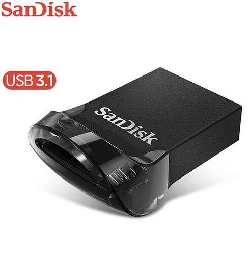

Hotter than when connected to my laptop, I would say in the Nova red hot, the bigger thumb drives aren’t as bad.
Strange, I’ve never noticed a USB stick getting particularly warm when connected to any Naim streamer I’ve had. I wonder if the USB port is supplying it with more power that it should?
I don’t think, too much power can be pushed; the voltage is fix (5V, unless you move to USB-C and USB-PD (PowerDelivery)) and as such, the device can pull as much power, as it needs (as long as the host can supply that).
What might be a reason for difference:
- Many PCs will “power-down” attached disks/devices after some time. Hence, they may cool down. I think, the Naim equipment keeps them “on”, hence if a device gets warm over time (though idle), it will do so.
- USB-3 devices can draw more power, than older USB-2 devices. And then it will depend on the “smartness” of the controller in the stick/SSD, how much it draws “on idle” (=without active read/write access). Typically, the cheaper devices (=sticks) have less optimized controllers (compared to “real SSDs”). I’ve read tests, that especially USB-3 sticks designed for “higher speeds” (which is not needed when playing music, but may be convenient when putting new music onto it) draw significant power in idle (1+ Watt), hence not advices to keep connected to laptops. (Sucking the battery empty.)
- Then, the USB-to-SATA (or USB-to-PCIe, …) converter chip also has a big impact here.
- Last, the smaller the device, the more difficult it is to radiate the heat. The higher the average temperature.
So, getting a “better/smartet” but also “slower” device is advisable.
An external SSD containing a PCI-Express SSD drive (which is capable of very fast speeds, even beyond 1 GByte/s) is surely not advisable for an always-on storage for reading music. (They can draw 4-5 Watt on idle and the speed is wasted.)
Unless it really gets hot (especially in cramped spaces), it should not really hurt; except if concerned for the power draw - which is still small, compared to other parts of a kept-on HiFi equipment?
All just to be clear USB drive like this (Red hot), but the bigger ones also get very warm, same with around 6 of these i have all San Disk.
The Naim USB ports provide a fairly generous 12W to cover the use of more power hungry USB3 drives, and the drives do remain powered up in standby. Whether this accounts for the heat you feel from a memory stick I wouldn’t know, although I would guess that it’s harmless enough unless there’s a fault somewhere.
My, this is tiny indeed. Little surface to get rid of the heat.
12 Watts? Yes, that should be power aplenty for all drives.
(USB-2 only had 2,5 Watts (as per standard), USB-3 only requires 4,5W. Many ports deliver more today, mostly for charing phones and tablets and stuff.)
Woops! Sorry, I meant Watts, of course. Post edited.
