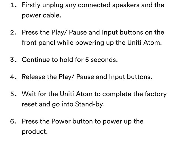

It’s worth trying the reset procedure:
Thanks. I did try this and no luck.
That’s a shame. May I just check that you either removed the mains cable from the back, or turned it off at the wall. Switching off with the front power button will not do it. The next step is your dealer, or call Naim Support.
