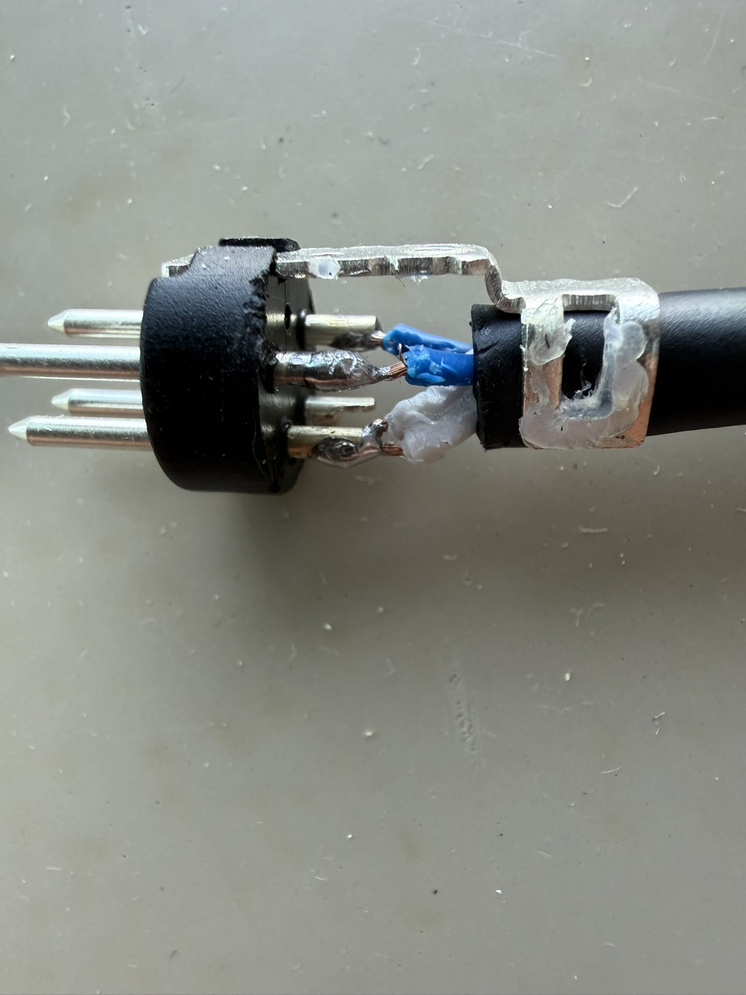

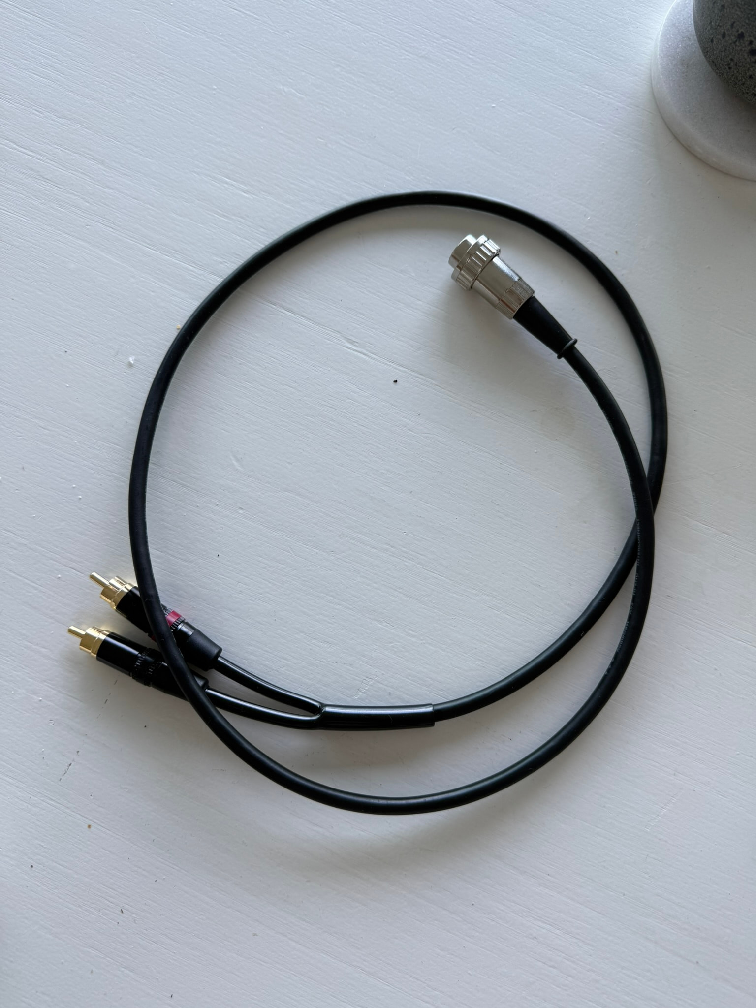

I ended up buying a cheaper DIN4-to-RCA cable instead. The build quality looks decent, but I’m getting a strange result: there is audio, and I can clearly hear music playing, but the sound is very low in volume and has almost no bass. Other sources connected directly to the McIntosh sound perfectly fine with strong bass.

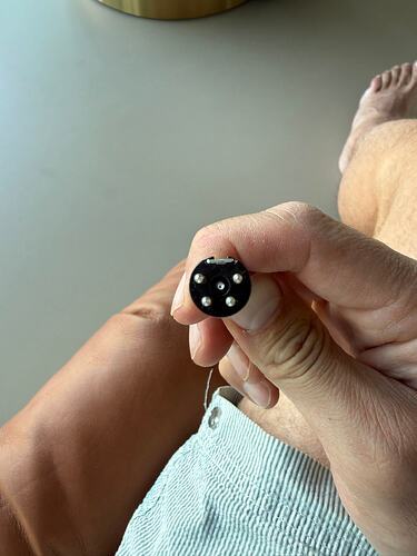

I’ve done some research online and on this forum about the correct DIN4 pinout for the Naim pre-out, and from what I’ve found it seems like the wiring on my cable is correct: the left and right signal (+) wires go to the two upper pins (i don’t know if I am correct with L and R, but in any case both positives each go to a dedicated pin), and the ground wires from both RCA connectors are joined together and connected to a single pin (with one pin left unconnected). But I’m not 100% sure, and I’m wondering if I’m missing something.
For reference, I’ll attach a photo of the DIN4 connector so you can see exactly how it’s wired.
Has anyone experienced something similar? Could the wiring still be wrong despite what I found, or is there something else that could explain the weak, bass-light sound? Any help would be greatly appreciated!

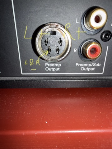

The DIN4 output socket is wired like this:
CH1 = Left CH2 = Right
The fault that is affecting the RCA preout is likely going to influence the DIN preout, as they are very closely related.
It probably just needs a new relay.
Regards
Neil.
Thanks.
Do I understand correctly that I don’t use the +ve in my case and the grounds of both the channels should be connected to -ve?
In that case the cable seems to be connected to the din4 plug correctly.
