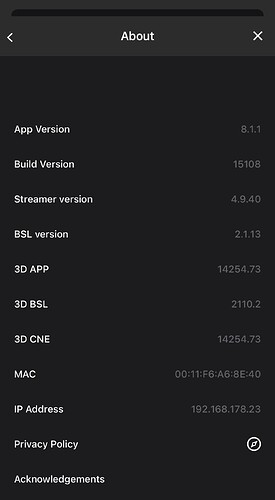

These are the values in about the app
So delete the five presets and then I suggest turn off the UnitiLite at the mains, wait a minute and turn it on again. Hopefully now it won’t try to find Naim Radio and instead populate the iradio index.
