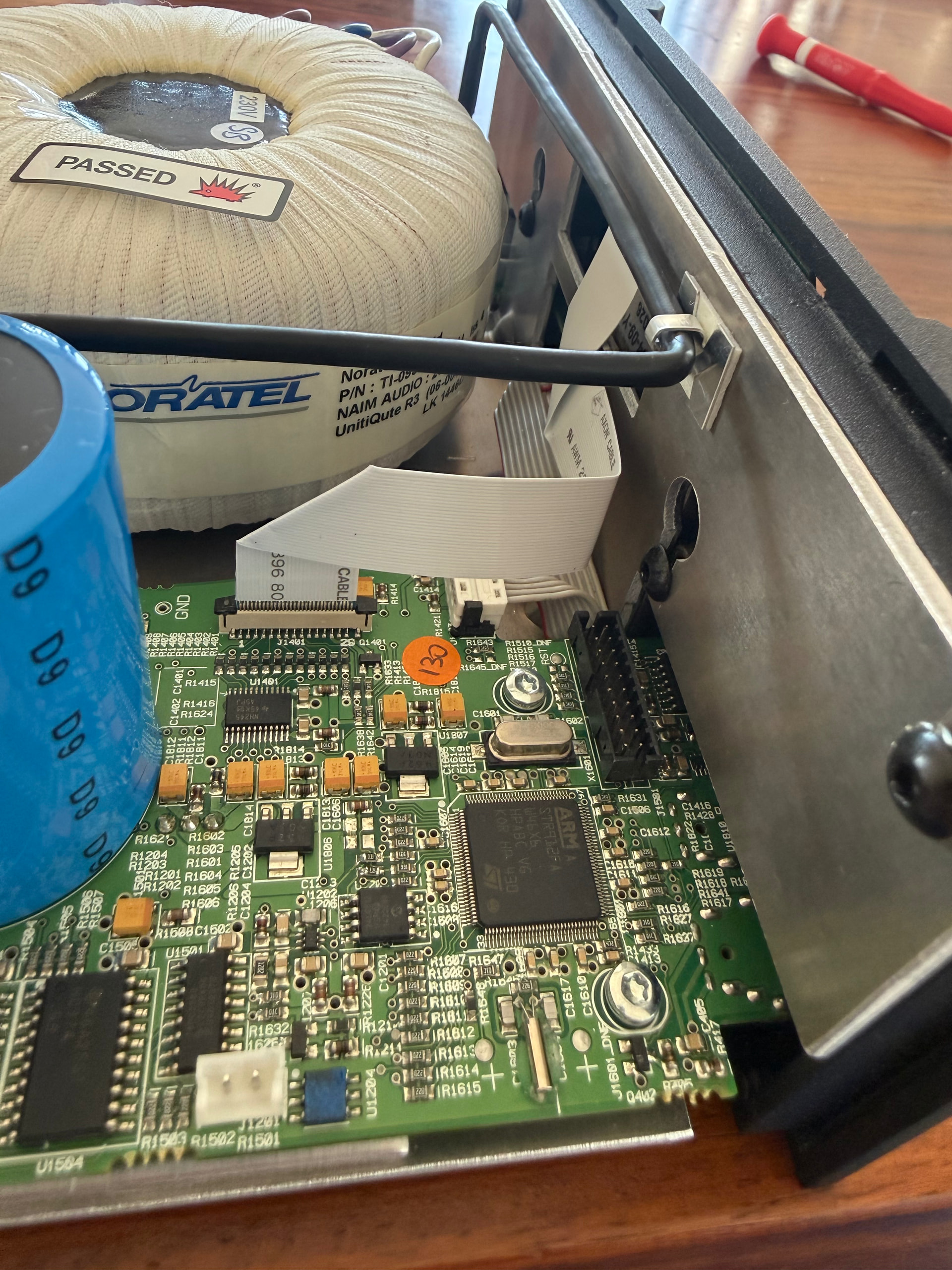

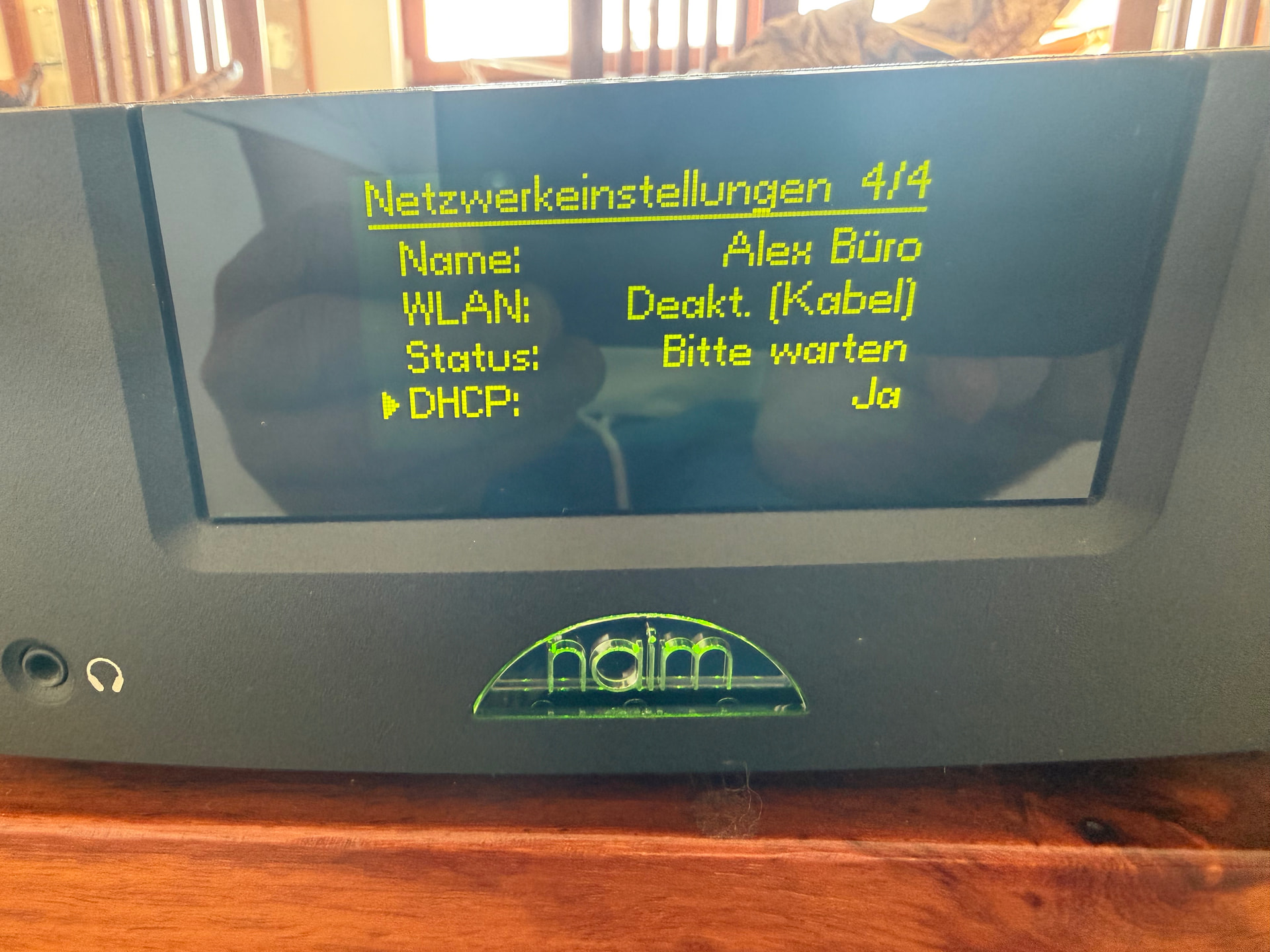

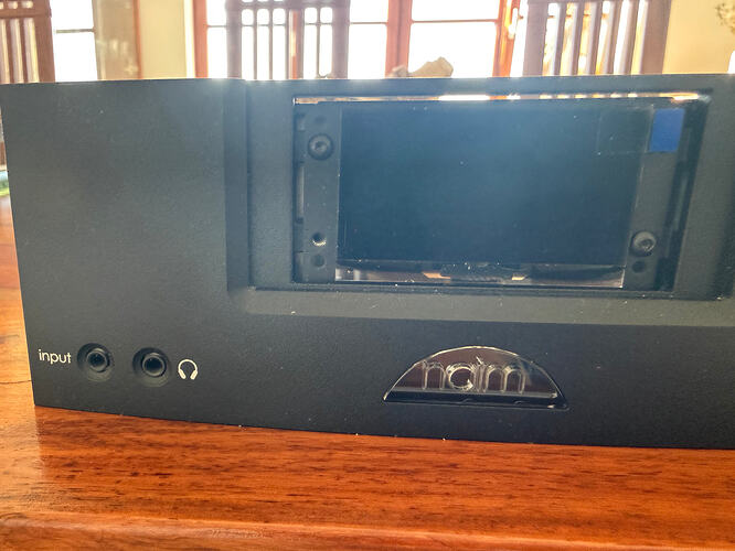

Good Morning. New Display done by myself. 5 Minuted work. I don‘t know why I done it before

Hello, Many thanks. I have Never done such cable Connections before. But it‘s realy easy. Only thing was that I didn‘t know that the Front Panel is glued, and it took a Long time to find this out. but if you know this, it‘s Maximum 5 Minutes work
