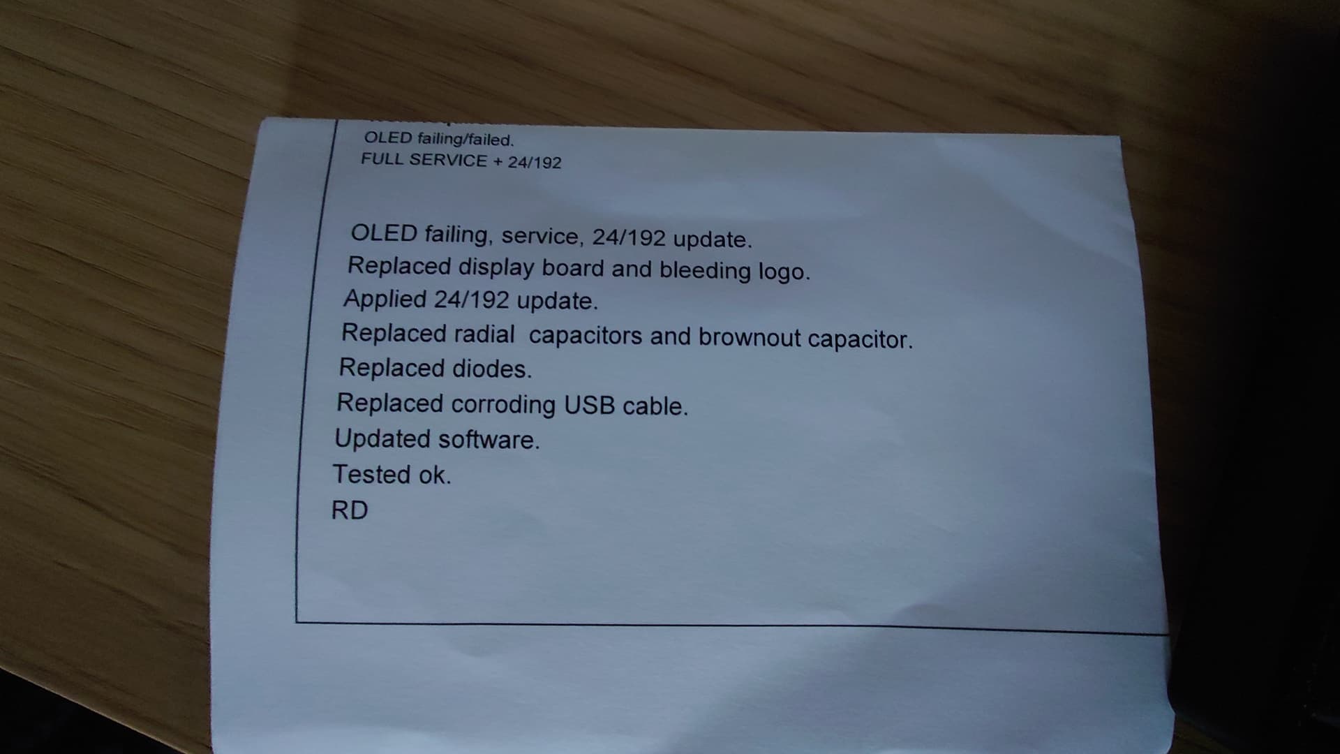

Agree with the service recommendation, I had mine serviced when I had its screen and streaming board replaced, several capacitors and a corroded USB cable were replaced.
Hopefully they wouldn’t charge the service plus repair price in your case @Sbcinternational
