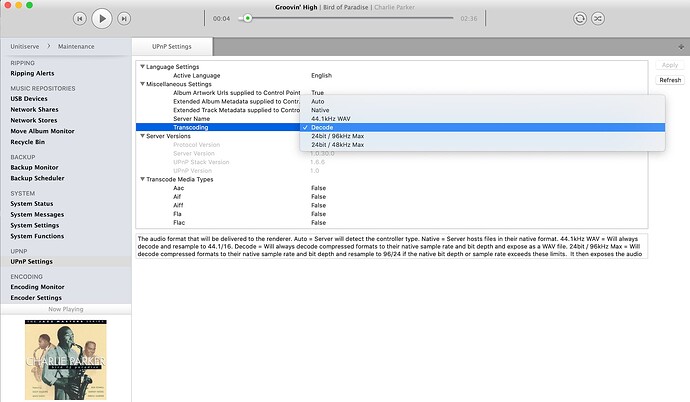

As you have a 1st gen Naim streamer you may want to use WAV for best sound quality. So having transcoded everything to FLAC, you can set the US to transcode back to WAV ‘on the fly’ using this setting:

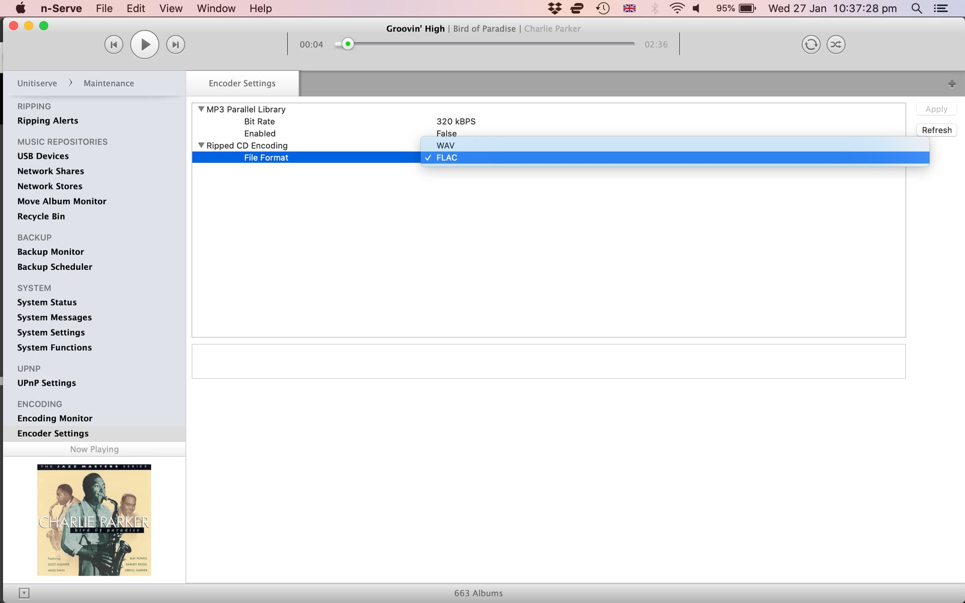

To ensure that any future CD rips are also saved as FLAC do this:
Be aware that ripping takes a bit longer if you use this setting, as the US saves the rip as WAV, and then transcodes it to FLAC. If you rip a number of discs the queue can back up, and I find it best to wait until all this transcoding is complete before you attempt to play or edit anything. Probably not an issue for you as you are presumably moving on from the US but just to give the full picture.

Yes, I have always had the Unitiserve set to transcode on the fly. It always amazes me that the Naim Core can’t do this.

Hello Keith. When I had a SuperUniti and then a 272, I stored the files in Flac but always had my upnp server set to transcode to WAV. To me it sounded nicer and more natural. The reason is believed to be that it gave the streamer less work to do when it unpacked the files. The new streamers have much more powerful processing powers and therefore this is less of an issue. Since getting my NDX2 I still have the files transcoded to WAV, simply because I can’t be bothered to try the options. The general view seems to be that the format makes little if any difference.
I found a subtle but clear improvement using WAV rather than FLAC with Unitiserve and NDX. With NDX2 I’m pretty certain that I can’t tell the difference.
With Roon it becomes irrelevant as the Roon Core will unpack the file and give you a straight PCM stream regardless of whether it was stored as FLAC or WAV.
Minimserver and Asset can also be set to transcode ‘on the fly’ if you prefer.

I’m not sure if the Prestige has Minimstreamer so I will precede with caution. It looks like the Unitiserve will convert back to WAV so perhaps the move to FLAC isn’t as scary as I thought.
