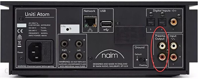

Can any of you help me how to connect Unity Atom with Muso via cable? I am looking for such a solution to remove the delay problem in party mode when the sound source is the TV
Stereo rca phono on one end, (atom preamp out), 3.5mm stereo Jack plug on the other end (Mu so line input).
These are the only output/input sockets compatible with each other.

Thanks Robert but it doesn’t work, Mu So doesn’t detect sound from Unity Atom

Have you selected the line in input? That will play whatever is coming out of the atom. You will need to use both volume controls.

I chose preamp output . I played Tidal Unity Atom + Mu so in party mode, there was a better stage and increased power, stereo sound and timbre was consistent

What I am proposing with that cable is not multiroom. Effectively it’s biamping. Play anything on the atom, and the sound comes out of the atom pre out socket. Any amp on the end of that will play the same using it as a line input signal. So skip multiroom / party mode as you call it. Play something on the atom. Turn on the muso, select line input (the socket on the right hand side, with a cable connected to the atom) and you will hear the same thing. No lag.

Robert , Do you have such a connection? It doesn’t work for me. Maybe Naim blocked it
