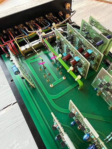

I tried all the inputs again and found that I could hear audio albeit with background “machine gun pop pop pop noise”. With no audio input the noise increased with the Volume knob turning louder when the CD input was selected , but not on any of the other inputs.

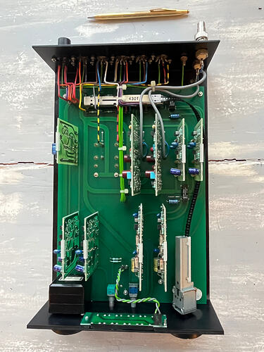

I opened up the 72 and removed the MC cards from their slots and all feedback noise ceased. Hurrah !!
I then replaced the MM cards feeding the BNC phono inputs with MC phono cards and hey presto that worked as well.

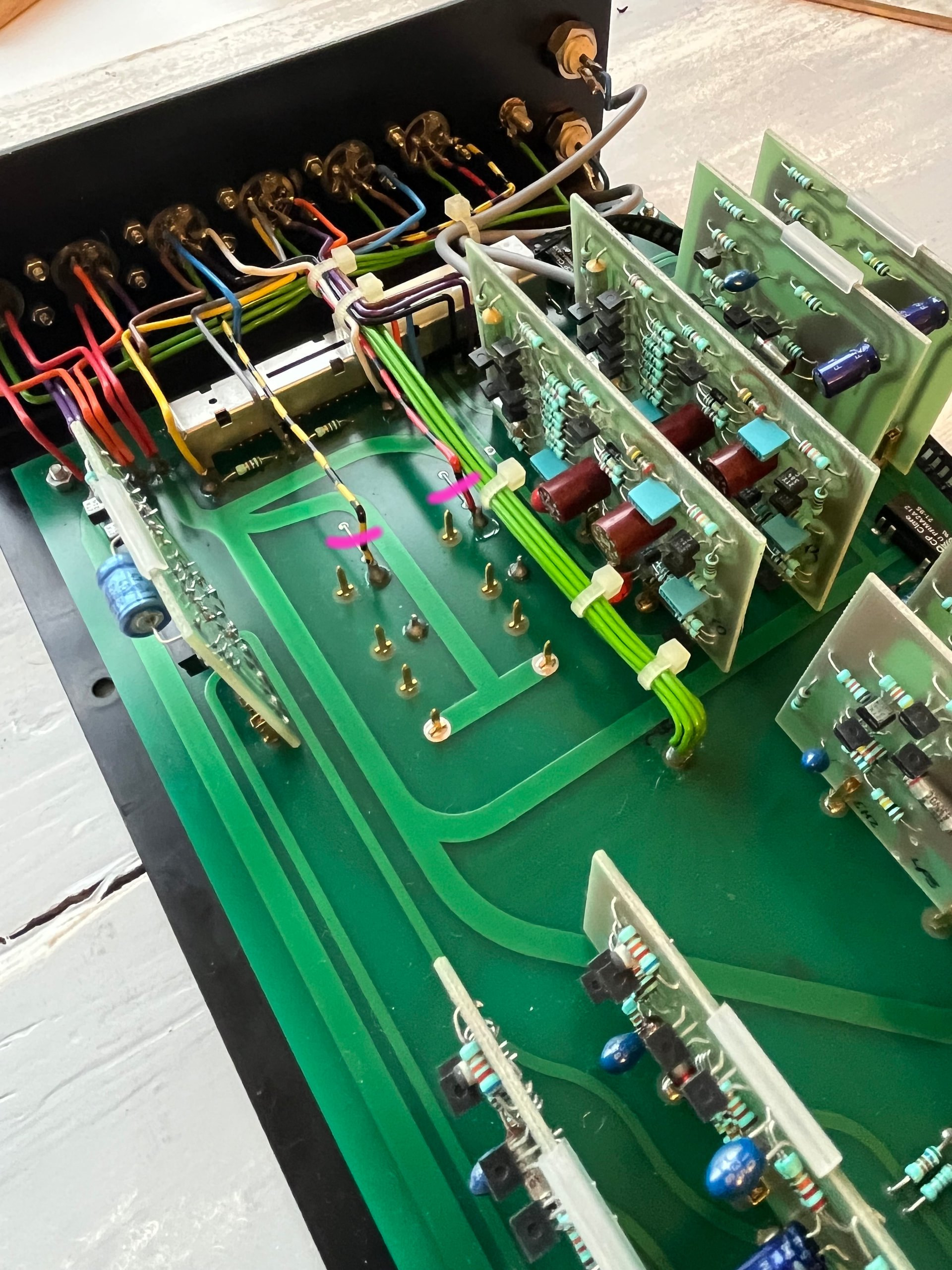

I reckon the MC boards were stored in those “CD ?” slots for safe keeping as the unit had been stored for some time. Those slots are now empty (as you can see : every thing works so I don’t know what purpose they are used for).
See a picture of the empty slots
FWIW I still get a hum when the machine turns on and then after three seconds there are a couple of clicks and the hum disappears. It seems to happen when I turn the machine off, a thump then a hum , a couple of clicks . Can anyone explain this ?

The CD input will work as next to the input wires (yellow/black & red/black) are the links that bypass any fitted board. What could be fitted there (with the links cut) was a variable input board which was designed to attenuate and filter the signal from early CD players but the general consensus is they are detrimental to the sound.
Hums and clicks are perfectly normal - the 72 has a mute relay which disconnects the 140 during power up and subsequently disconnects during power down. If you added a Hicap and kept the 72 powered on then you could turn the 140 on and off with no noises.
The hum can be reduced if you tie the signal ground to mains earth. Traditionally this would be achieved by connecting a naim source. (CD player, streamer). The other way to do it is an earth wire from the ground post on the back of the 72 to the earth pin of a mains outlet.

As said above - when you switch on, the main thump is from the power amp, followed by light hum as the power amp input is floating. The next couple of pops are each channel of the double pole output relay in the preamp closing.
When you switch off, the main thump comes from the preamp losing power, followed by the floating input hum, then the next couple of pops are each channel of the power amp discharging.

You need to cut these two links if cards are fitted to these slots… The wire links, not the cables.. :slightly_smiling_face:
