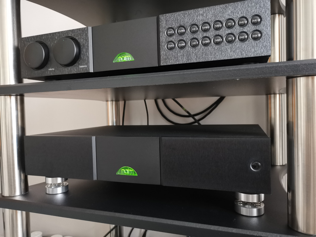

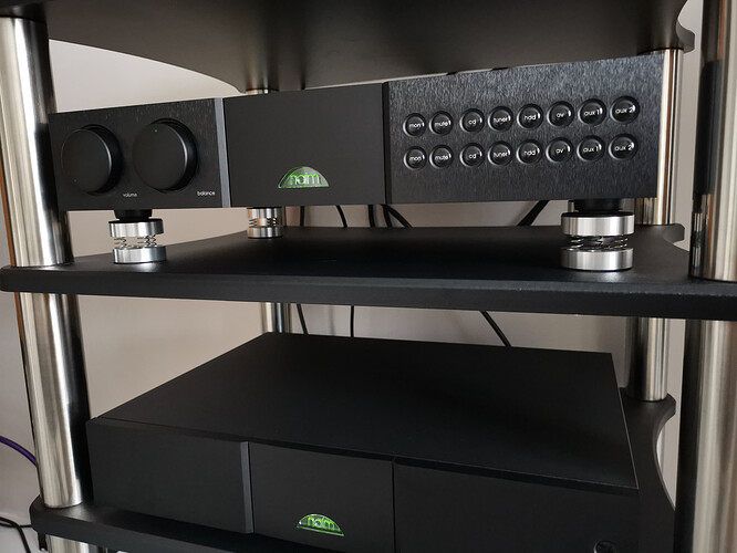

Hi, I have upgraded my 282/HCDR/250DR to 252/SCDR/300DR few days ago. These are 2021 built units that have been in storage for a while. How long do you think it would take to sound at their best? It sounds certainly better than 282/250, but not as much as I might have expected, probably not yet.
My dealer always tells me to give it three weeks before seriously listening to how something sounds.
My only comment might be to try your kit with and without the fancy feet. Naim do a great job of tuning everything, even their rubber feet, to work well with the sound.
Good luck with your new kit and enjoy your music.
Three weeks is quite a long time. I didn’t know it would take that long. I have tried without feet before, but sounds compressed and slow. I will look into proper HiFi rack in the future.

Your rack does look like an awful lot of glass and steel, and saying that your kit sounds compressed and slow without the feet makes me think it might not be a good fit for your Naim kit. I would seriously look at a proper rack. A Fraim is the obvious choice or Quadraspire?
Thank you Richard. I have successfully dressed Burndy and SNAIC as you have instructed. Do used units that have been powered down for a while still take time to sound right?
Fraim is what I would like to go for.

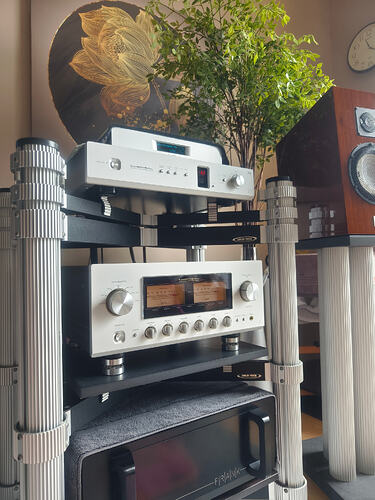

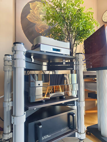

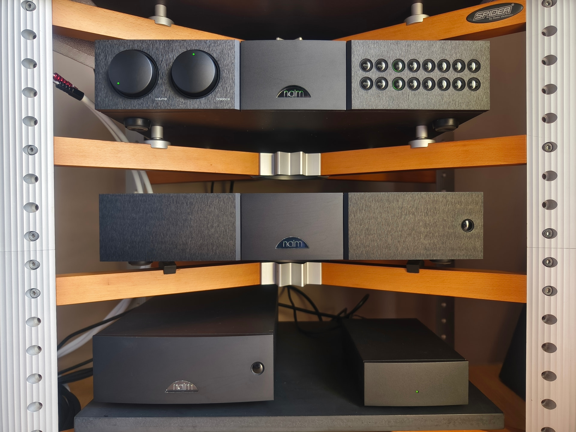

Of course Fraim may be the best support for Naim components but I’m not actually recommending it. I’m just sharing my experience on the racks that I’ve used in my system as follows.
  1. Finite Elemente Spider - used with Naim components for more than a decade, still using it with the Naim.
  1. Cheap made in China rack - owned for a short period. Tried it with the Naim and it didn’t sound good, added Nobsound isolators in various configurations and although there was an improvement in sound quality it’s still an overall poor sound. Sold it after a while.
  1. Solid Tech Rack of Silence Reference - Everything sounds good on this rack though it’s mainly used with the Gryphon and Luxman.
