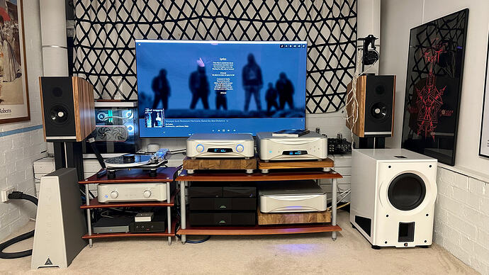

Yes, I’m using bookshelf speakers. What prompted me to add a sub was that I had replaced my old floorstanding speakers with the aforementioned bookshelves due to the former being too bass-heavy for the small listening space they were in. I loved the new sound but as someone who indulges in loud, heavy music and one that goes to gigs on the semi-regular I was missing that visceral physicality you can only get with larger speakers.
So, after some research I added a sub mainly on the notion that a sub can be tuned to fit into even a modest space whereas a larger speaker leaves you with little recourse to pare back the lower frequencies. And that’s pretty much how things have shaken out.
A pic for reference:
