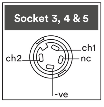

This is the Supercap’s pins.
The 552 PS will be the same as you can connect a 250 to either, using the same supplied cable.
The DIN 4 pin-out is a standard naim have used for decades across the supercap, hicap and 552PS.
Top left pin - channel 2 (right signal)
Top right pin - channel 1 (left signal)
Bottom right - nc
Bottom left - signal ground

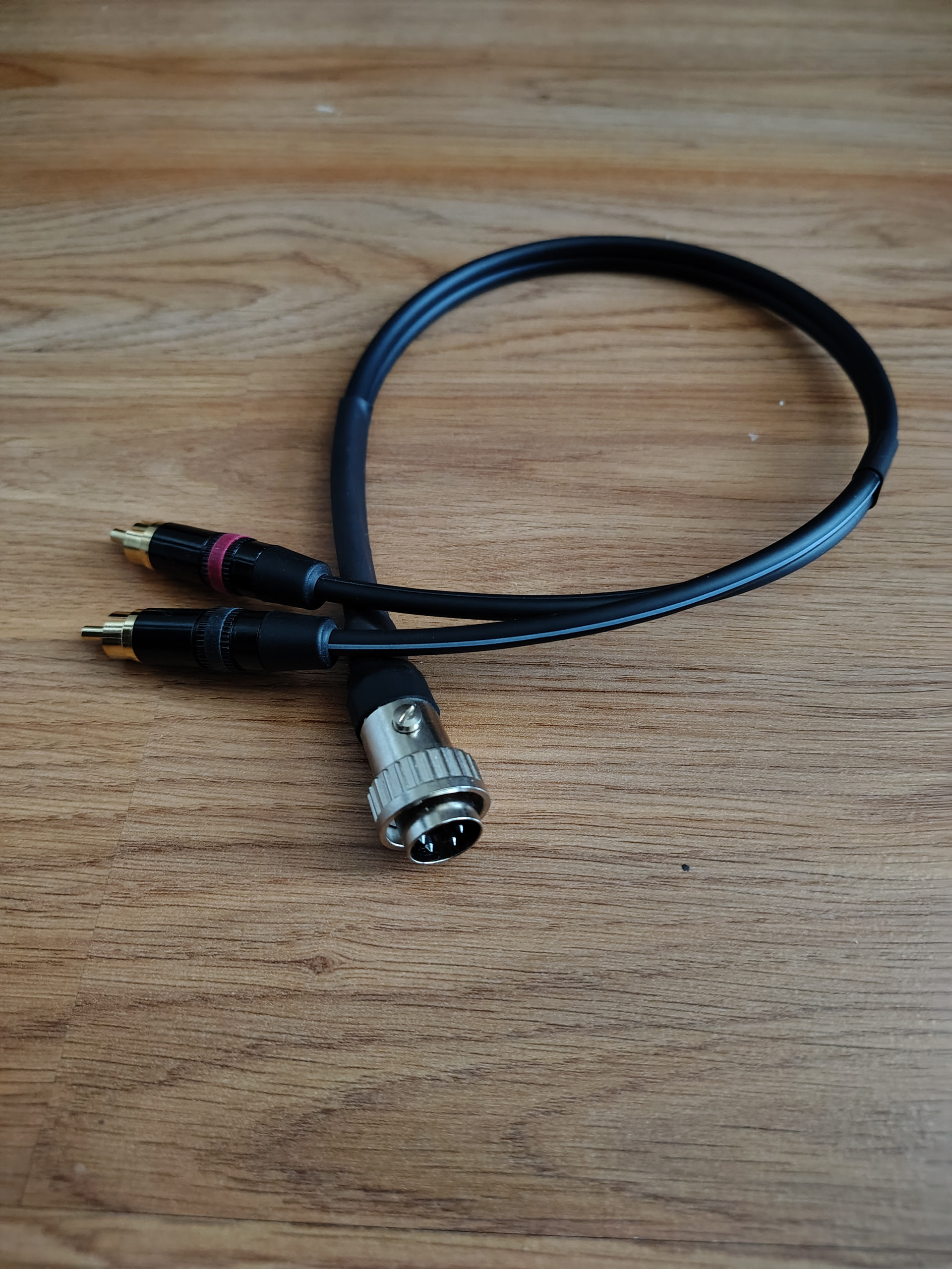

4 pin Din to RCA:
Thank you. That is great!
I used to run a Rega power amp from the ps of my naim pre using two Naim supplied single channel cables, DIN one end, red or black RCA the other. Wouldn’t hurt to ask if they’ll still do them.
