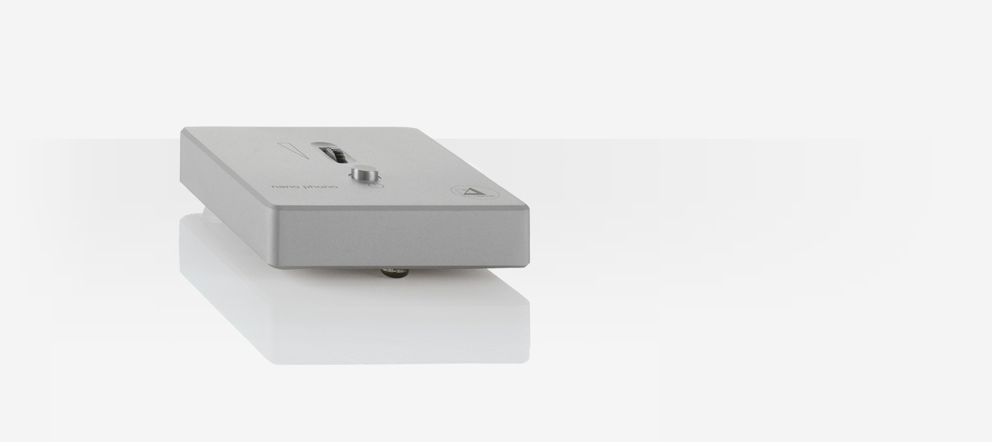

I’m using an input sensitivity of 0.5V and an input trim of +5 on the line in where I’ve got the record player plugged in via a Clearaudio Nano Phono preamp, could that have caused some sort of overload or something triggering a fault?
on my Nova PE, for my A/N phono preamp, I use a Input Sensitivity of 6,5V and Input Trim of 0.
In the settings it suggests a sensitivity of 2.5V. I’d try that, with no input trim.
MAX. OUTPUT VOLTAGE
10V eff. (1kHz), 0-10 adjustable
I had the sensitivity set to 0.5 because the volume was much lower than other inputs. I’ve now set the sensitivity to 2.5V and by increasing the gain on the phono amp and setting input trim to +8 the volume levels between inputs are roughly the same now.
