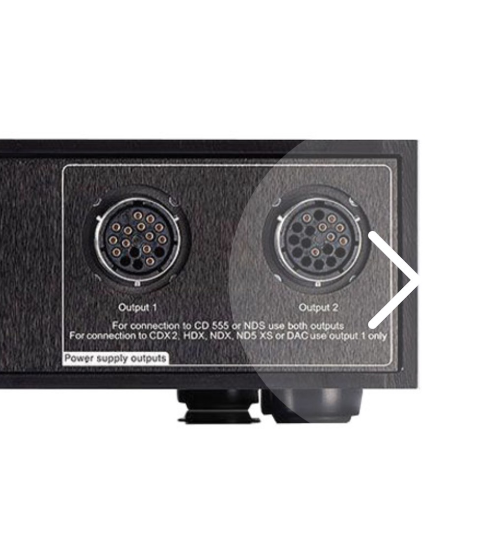

Which output socket will I use on the 555 PS to connect to the Naim DAC ?

Output 1, as written on the back of the 555PS.
