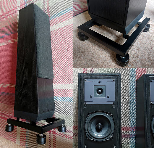

Owned for 35 years, and still sounding very enjoyable used with NC332 / NPX300 / NAP350 x 2. Updated to Mk2 by naim in the early nineties, I replaced the tweeters 3 years ago with the same Scanspeak model.
Changed the spikes to Stack Audio AUVA 50 Isolators last year, which has been an excellent improvement, adding to the musical enjoyment.
The higher power amplifiers benefit them greatly, though when I was only using a NAC332 with a NAP250DR the extra information and deeper soundstage was already remarkable.

thanks Jeff…. which drivers are they ? Early Mk2 or the later in-house drivers ? It would appear mine may have been updated to Mk2 spec but my drivers look different to yours sir ! Wonderful system you have there, what were you using before the move to the new stuff ?

Love the way you have done your pics as a page layout, Geoff!

I really don’t know which Mk2 bass drivers they are → I took them to the factory in Salisbury to be updated in the middle of the day and they were ready to be collected later the same afternoon! Though I do recall this was quite a while after the upgrade was introduced.
