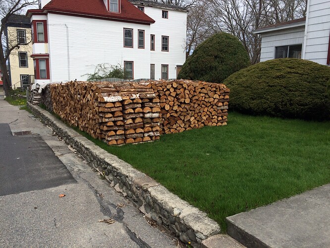

Up there people normally have their wood delivered in the Spring and let it sit out on their yard to dry until September time when they bring it in to a shed/storage.

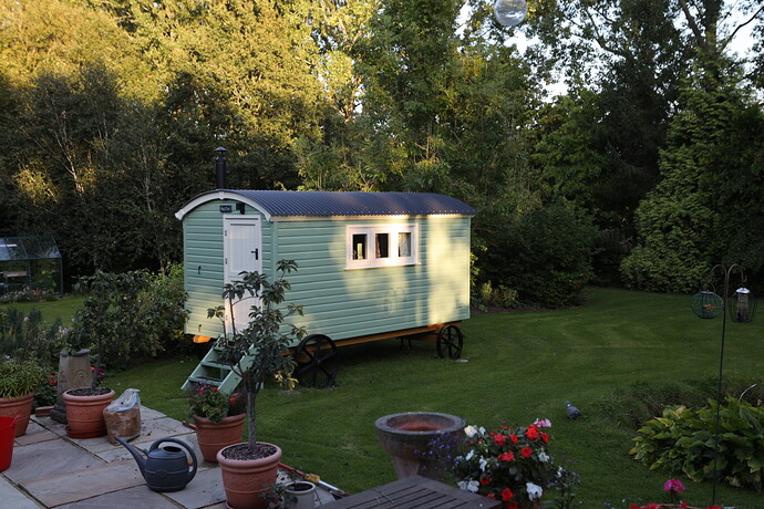

Check out Salamander stoves. We have one in our shepherd’s hut in the garden. Wonderful and even made in Devon. The hut needed fire boards on two sides plus a stone floor - lime slab from our neighbour’s posh new kitchen. The chimney is a double skinned one and installed by a guy who does narrow boats in Brighton. We needed to include a floor vent and a CO monitor to comply.
Oh sorry, this is the outside…can supply inside if you are interested.

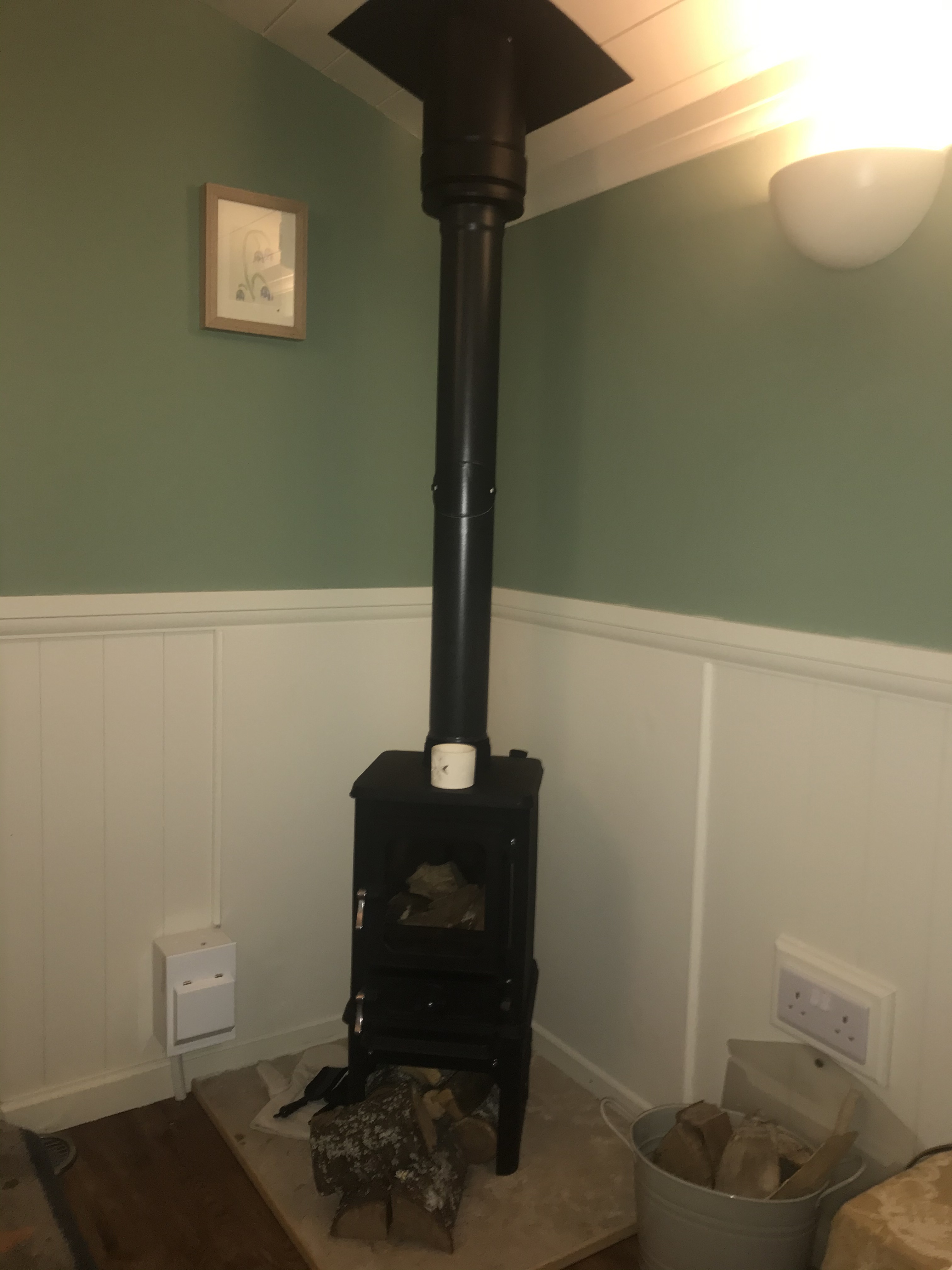

I’ll take one tomorrow for you. We have the Hobbit with the log stand. The double walled chimney starts 30 cms before it passes through the roof.
OK - managed to nip out and take one just now

Thanks for taking the time to photograph the stove, it looks like a really good option for us.

Our installer really knew what he was doing and said that he’s seen some horrors in the past with single skinned flues installed through wooden roof spaces.
That Hobbit does get warm though!
